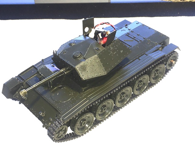

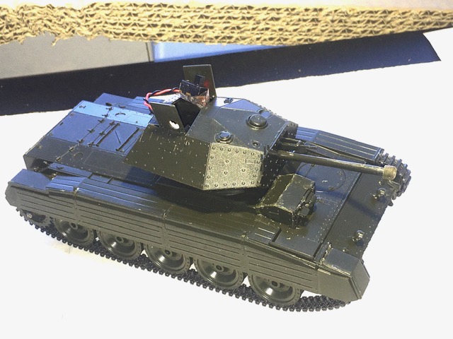

I rushed the assembly of the MTM gearbox and that resulted in axle failure so now I need more parts to fix that problem but in the meantime, I have decided to fit a Tamiya gearbox in this Crusader to get it moving 8) This may be a better option for the Crusader as it needs the ability to have an adjustable track tension type gearbox in order for it to work as a radio control tank. I have noticed a lot of these older 1/35 models have Tracks that are too tight due to polymer track shrinking slightly due to age is my guess. I just could not resolve this issue using the MTM gearbox on this particular model due to the design of the hull where the drive axles exit.
So anyway I will continue with the Crusader build here. When I get repair parts for the MTM gearbox, I will continue at the original thread above

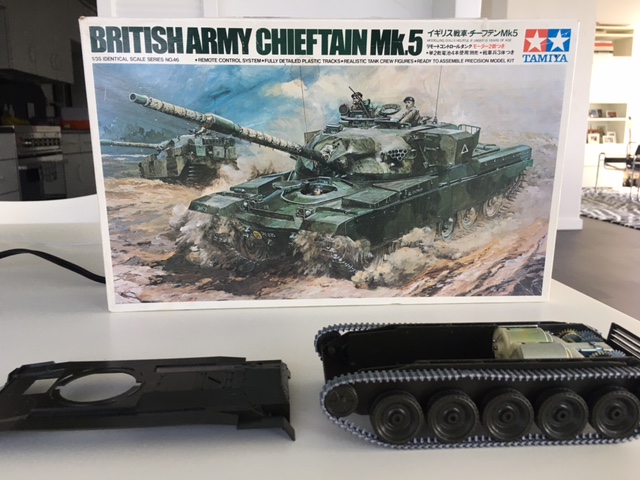

I just happen to have a brand new Tamiya gearbox from a rare NOS British Chieftain Mk.5. I will borrow that gearbox for this project for now as I want it to run NOW ;) I will not be trimming the axles of this gearbox and they will stick out a little beyond the Sprockets but that does not bother me.
Tamiya gearbox came from this rare Chieftain Mk.5 motorized remote control model Tank.
getting the rear hull plate installed can be a challenge when upgrading to motorized.

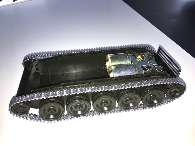

Now it has Track tension available. It is moved as far forward (less tension) as possible.
Was not too hard to get this to work with no outward modifications visible

I have successfully added a Tamiya gearbox to this Crusader and now I am going to add plastic Individual Track Link (ITL) tracks. The stock tracks are proving to be a little delicate and I have broken the right track twice just from the torque of turning in place (0 turning). So far I have one ITL track installed.

I got more work done on the Crusader with the metal gearbox. The ITL tracks that I was using which are for a early production Panzer III with narrow tracks, are not working out on the Crusader so I went back to the poly tracks and both broke repeatedly and I realized that I had got an NOS model with aged tracks. I ordered another on ebay for $25 shipped. This one is newer and is Tan in color which I prefer over Olive drab. Anyway, it also has dark colored tracks vs the silver ones from the NOS model and these seems much stronger so I mounted them on the NOS model and tried again. Success! and a good thing as I can not find after market tracks for the Crusader.

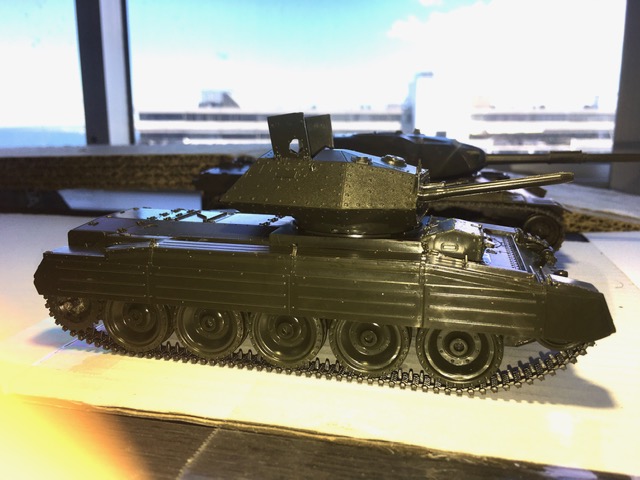

The next hurdle was to secure the upper hull to the lower hull so that is is removable. Figured that out and now I am ready for final assembly. You can build this two ways as far as the shirts are concerned and I decided to go with the desert skirts like used in the Africa corps units.
video. Track Skirt is on one side in this video. Some more detail work needs done yet. Upper body is secure to hull with 2 micro screws in the rear body side. Front is secured with factory body stay mounts.
Crusader MK III Video
https://youtu.be/qqvVbkViJzE

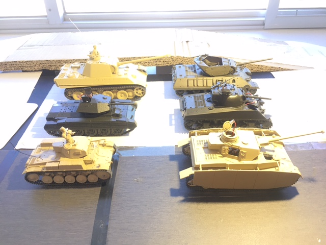

The Crusader MK III is a medium tank and looks a bit outdated next to the Centurion Mk III
Some of my best RRC WW II models
Installed one skirt to see if it works without problems and it works great so the other one goes on asap
This is the only running RRC WWII British Tank in my collection. The dark grey poly tracks are from Italeri model #2 and work excellent. These are from a recent production run of this model as the (dark grey tracks) feel stronger compared to the NOS (silver tracks ) model #1
This is a super cool model. Had to buy two to get some good tracks. I would like to try the Tamiya version next.

Well, I thought I had this Tank build done as far as running gear and radio installation are concerned but then the other day I went to run my lovely Crusader when disaster struck! :O Both tracks popped at the same time while climbing a hill :(
Sad to say but the poly tracks that come with this kit are not suitable for radio control conversion. I started looking in earnest for a set of tracks for the Crusader and the only thing I can find is Friulmodel metal tracks and I decided to "give it a go" with these tracks on this model which already has a HD gearbox so it should work me thinks.
