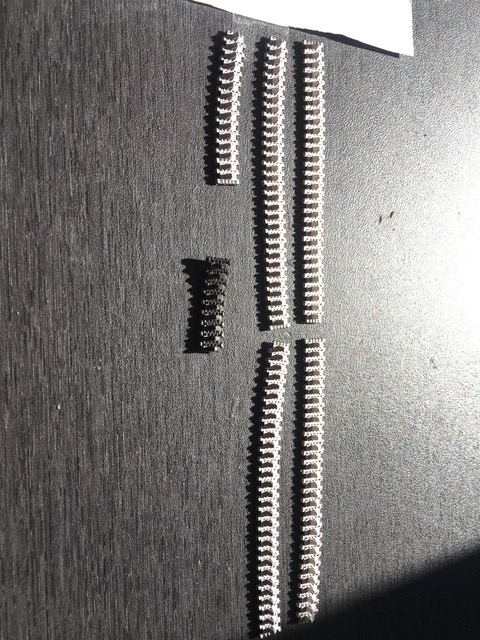

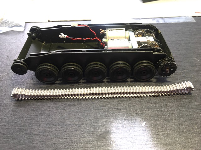

Oh forgot to mention what ITL means. ITL "Individual track links "come in two types, plastic, metal. The latter is much easier to work with IMO. I built a plastic ITL track for a Panzer III, IV and found out that there are several types for these Tanks and of course I had the wrong one for my model so the one I built did not work for my model but the experience was not a total waist of time, I did learn that plastic ITL is "maddening :crazy: " to build. So I tried a friulmodel metal ITL kit for a Chieftain and they were actually not that bad with respect to plastic ITL.
These plastic ITL tracks are 5 times harder to work with and are a bit flimsy and no where can I find where someone is using them on a model that runs under its own power. I had one on a Crusader which kinda fit but after a short while started to slip on the drive sprocket. Also there is a lot of "streach of the track" under load so not sure plastic ITL works very well on RRC model.
This is my 2nd Friulmodel metal track kit.
IMG_8869 (1).JPG (92.9 KiB) Viewed 2869 times

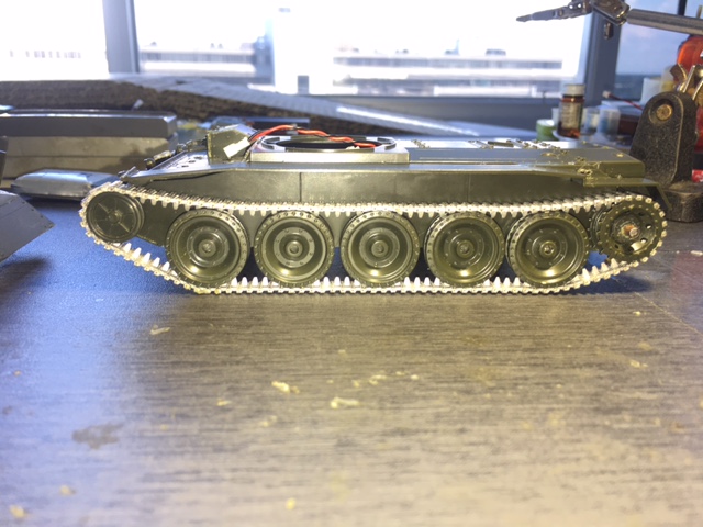

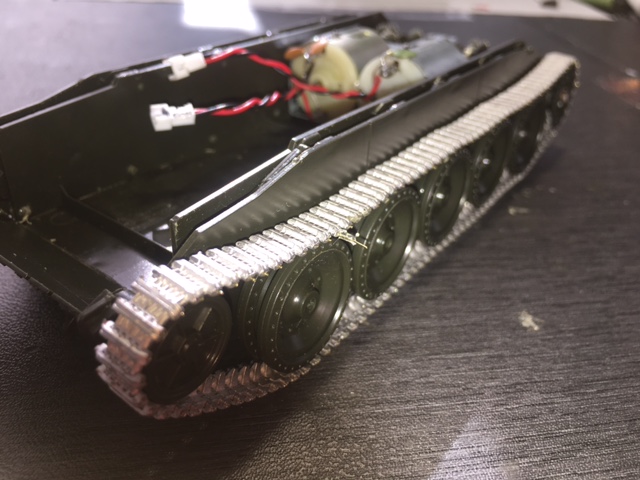

Finally got some time to hang this track today :D
I am using this tank to size the tracks for the Desert MTM version build. This will give me the centerline of the drive sprocket axle location.
maximum "track sag" at the other side of the track adjustment. the optimal setting will be revealed on the work bench "proving ground" track.
gearbox mounting screw (tension) moved all the way back equals proper track tension set. I say proper because there is adjustment the other way to set more <br /><br />&quot;quote from Herr doctor, &quot;track sag&quot;
"quote from Herr doctor, "track sag"
track tension is set right in the middle and now ready for final track adjustment. The gearbox adjustment screw makes hanging the track go much smoother.
last track pin installed and now the track is ready to hang on the Crusader
ready for the last track pin

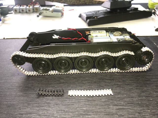

120 Individual tracks links (ITL) USED for each side of the Crusader. The bottom 15 ITL links are spares so 135 ITL pieces available for each side. Every link went together with no issues in assembly and very little flash trimming required. These ere easy to build IMO.

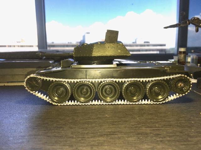

I got both tracks on the tank and have test driven the Crusader and it is a special day for me being able to drive this tank on my work bench track as a metal track tank :D and
44 years ago,(1978), I built my first Radio Remote Controlled tank using the Italeri Crusader III with very crude toy grade radio equipment and now, I have built what I think is the star of my collection of 1/35 scale tanks with this new build. The metal tracks make it very special on any 1/35 scale model tank IMO. Since I built this one with the Tamiya all metal gearbox, it is a keeper and I will treasure it in my collection and now the next phase is to build a Tan Desert version with MTM gearboxes and metal tracks.
Anyway here is a short video with the body on this dark green Crusader III. It is difficult to drive and do the video. The Tank is super smooth and the video does not do the tank justice.
https://youtu.be/4qA5UdMXFjg

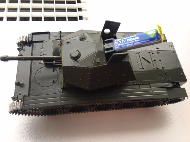

250 mah li-poly is plenty and if keeping the speed low can go 25 minutes or more.
Beautiful tank me thinks. The large road wheels look very good. I will not be running the track skirts on this one at this time.
Turret installed
Turret installed

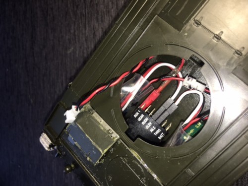

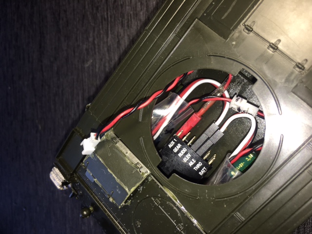

Thats right, Elevator and Aileron used for track drive with 4 mixes allows 1 handed driving so I can video as well lol
Upper Hull installed.
6 channel radio leaves room for future upgrades.

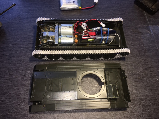

Very efficient setup allows long run times from this tiny 1s li-poly.

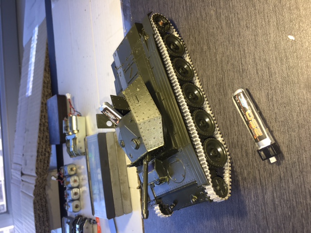

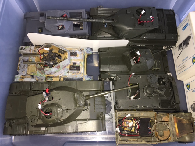

These are some of my best 1/35 scale RRC models
