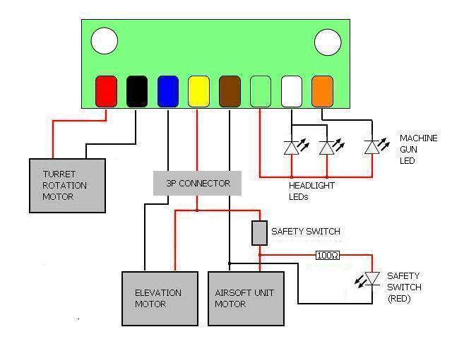

Hi all, I've had a look using the search function but couldn't find what I need. I'm trying to upgrade an old 27Mhz pershing, to 2.4Ghz for my son. I got the HL TK-7.0, I've fitted it and managed to get the driving sorted as well as the headlights and taillights, machine gun flash and sound, engine sounds, and smoke. What I can't get is turret or gun movement, as the original system had a plug with about 8 wires going into it, and the new board has separate plugs for each function. So firstly I'm assuming I need to source some of the correct connections to fit the new board, should it then just be a case of finding which wires operate which function?
The operation of the main gun I am assuming is pressing the button on the top right of the control and moving the left stick forwards, as it is on our other tanks, but this doesn't do anything, not even the noise. I'd assumed that as the rest of the noises work, engine, machine gun and even turret traverse and gun elevation despite neither gun or turret being connected, that the main gun would also work.

:D Indeed the connections are different ... it would have been easier to install an RX 18 type V2 or 3. In your case you will have to resume the wiring of the 8-pin plug, on the 7.0 each motor is connected by a plug 2 pins .ci attached photo of the corresponding wire colors

Jofaur86 wrote::D Indeed the connections are different ... it would have been easier to install an RX 18 type V2 or 3. In your case you will have to resume the wiring of the 8-pin plug, on the 7.0 each motor is connected by a plug 2 pins .ci attached photo of the corresponding wire colors
Is the RX18 V2 or 3 2.4ghz? It was specifically the 2.4Ghz I wanted to swap to so there was no aerial on the transmitter as the kids just end up breaking them or poking each other with them.
However, with that wiring diagram, once I find where I can get the correct plugs, I should be able to wire it all in to work. Last time I did this it was easy as I had a fully working 2.4Ghz Pershing, and a broken 27Mhz bulldog, ripped everything out of the bulldog and dropped the complete setup from the Pershing into the Bulldog. Easy.

:) Hello, yes it is 2.4 Ghz, the 27 Mhz is obsolete and no longer exists, here is a new link attached, which may help better? even if it's for a 6.0, hoping to have helped,
