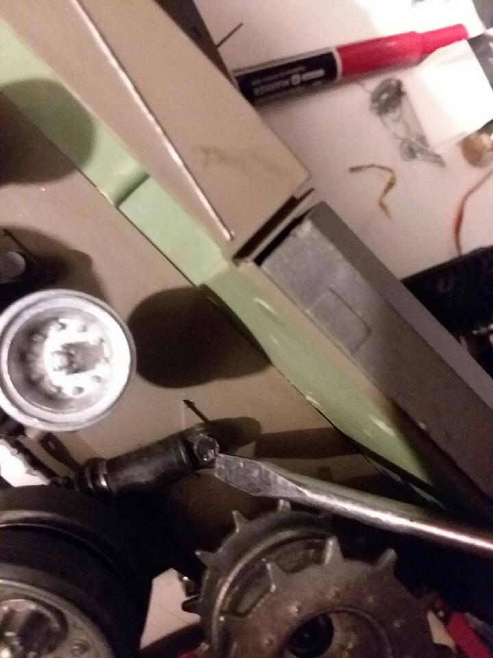

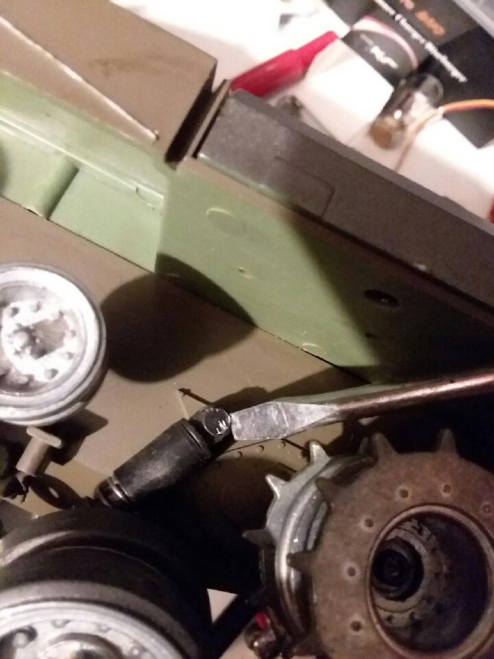

How does one remove the flat-headed, seemingly press-fitted (and probably glued as well) pin that connects the shock armature to the hull? I'm certain there's a better way than the (albeit barbaric) way I've envisioned...
I can make springs, as we all can, and so I'm eager to build up some beasties for the back 6 sets on this M41. But removing without destroying is always a challenge for me... So I figured I'd ask the seasoned vets first. I'm not a rich man, this one tank is what I get for the foreseeable future, and I'm lovin' it, so wreckin' it seems like a bad idea...

- Less bad picture 2. Screwdriver acts as finger tip as my fingers are a bit on the portly side for these tanks...
- Tank Shock Post 2.jpeg (71.88 KiB) Viewed 650 times
- Bad picture 1
- Tank Shock Post 1.jpeg (66.37 KiB) Viewed 650 times

Hi.
No magic wand but simple engineering principles.....
The pins are not glued in place they are splined and pressed in.
I get them out by using a pair of wire cutters, like the pic.
Place the cutter blades between the 2 parts you want to remove in this case the back of the shock mount and hull mounting point and gently squeeze the pliers shut and as the plastic cannot move it pushes the pin out as the blades close.....simples.
Once the pin has pushed out far enough you can get a pair of pliers on the flat head and pull it out...DONT TWIST IT, IT HAS SPLINES ON IT..

Re: Walker Bulldog shocks & motors
Excellent, thanks much! I've ordered the metal shocks, began building a few springs to test, and will be using those snips to not snip the pin out. Its always easiest to work on things disassembled. Especially for my sausage-esque fingers....
Again, thank you!
