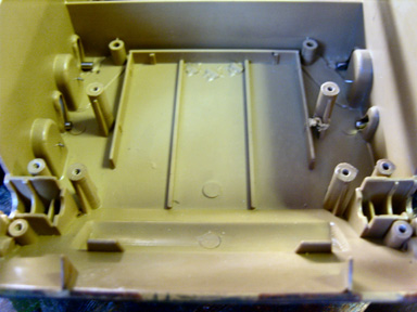

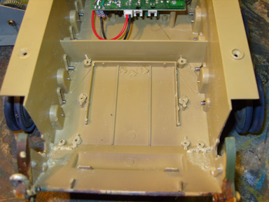

jrc
Posts: 387
Joined: Wed Aug 19, 2009 3:42 pm
Location: Ayrshire, Scotland
Re: matorro King Tiger
Post by jrc »
you may find this conversion easy and cheap using standard HL metal gears for your KT.
1 remove the old gears
2 cut off pegs
3 make a floor that you can attach new gear boxes to
4 fix it in place - job done
you can now remove that annoying bulge on the front!
