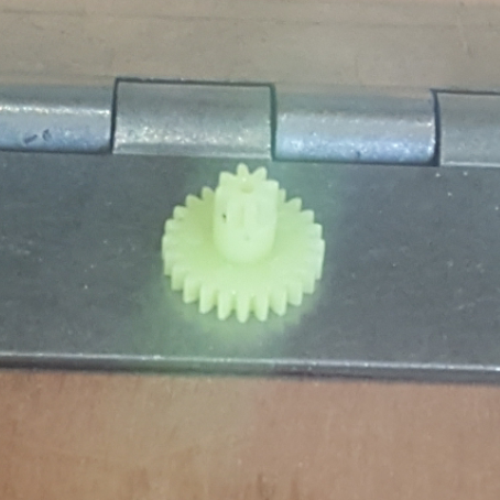

Does it look like this 24/8?
Posts: 7594
Re: Tokyo Marui Leopard 2 A5 broken firing
That's 11mm total length.
24 tooth is 16 diameter, 3 thick.
8 tooth is 6 diameter, 4 long plus another 4 for the smooth shaft between gears.
The bore runs smoothly on a 1.5 drill bit shank.
Looks like the two gears have different pitches.
Note, those measurements were only done with a tape measure and aging eyes, but they're very close to the round numbers :thumbup:

Son of a gun-ner wrote:Does it look like this 24/8?
That's it! :) fantastic, big question where can I get one?
