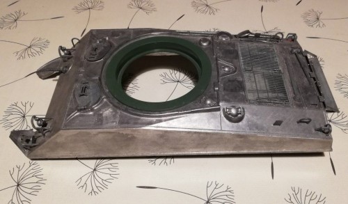

I'm sure one of our esteemed sherman aficionados has completed this swap. I've an older spare mato plastic upper hull from a Sharman M4A1 (76) and decided to fit a nice taigen turret with recoil and flash and sadly the tiagen offering is a wee bit larger in diameter...
I'm sure I can accomplish the swap just wanted some words of encouragement and maybe some advice from someone who has completed the swap.
Much appreciated.

I purchased just this setup from Ad Lav, but what he'd done is remove the rollers from under the turret, and cut out the Mato hull to fit a portion of the Taigen hull, with the hole into an enlarged hole in the Mato hull.

I wonder if the base from a Mato turret could be fitted to the bottom of the Taigen turret
Sadly I don't have a spare Mato turret bottom, but I do have a spare Heng Long turret bottom you could somehow fit to the Taigen turret, although, I don't think the Mato and Heng Long turret holes are exactly the same, but they're very close.

Or, the other alternative is, I remove the portion of Taigen hole in my Mato hull, and send it to you if you don't have anything to use.
As quite honestly, I want to fit a Heng Long turret to this particular hull, and I didn't realise at the time it had/needed this modification.
The portion of Taigen hull is circular at about 5mm wide. (Why is it when I type in "wide" my phone always offers me "wife." . . . . Must have seen her. . . .)

I believe that will be my approach Mick. Shouldn't be too hard to accomplish.Son of a gun-ner wrote:I purchased just this setup from Ad Lav, but what he'd done is remove the rollers from under the turret, and cut out the Mato hull to fit a portion of the Taigen hull, with the hole into an enlarged hole in the Mato hull.
I assumed it was a straight forward swap. Should be fun!

Same operation as on my Sherman - sandwitch Taigen lower - Mato upper - Taigen Turret. As I had Taigen plastic hull, I cut ring and glue to Mato hull after widening the hole. Lots of sanding and cutting using roraty tool.
