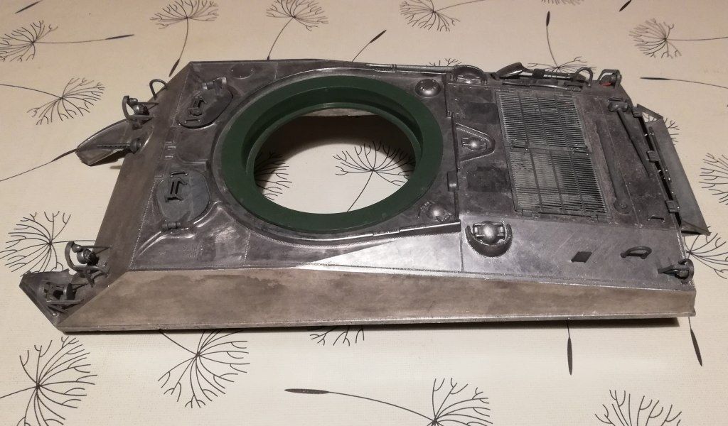

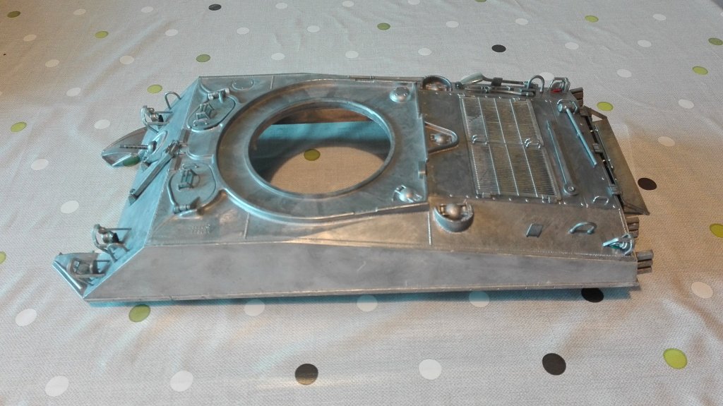

I'm sure one of our esteemed sherman aficionados has completed this swap. I've an older spare mato plastic upper hull from a Sharman M4A1 (76) and decided to fit a nice taigen turret with recoil and flash and sadly the tiagen offering is a wee bit larger in diameter...
I'm sure I can accomplish the swap just wanted some words of encouragement and maybe some advice from someone who has completed the swap.
Much appreciated.

I purchased just this setup from Ad Lav, but what he'd done is remove the rollers from under the turret, and cut out the Mato hull to fit a portion of the Taigen hull, with the hole into an enlarged hole in the Mato hull.

Son of a gun-ner wrote:I purchased just this setup from Ad Lav, but what he'd done is remove the rollers from under the turret, and cut out the Mato hull to fit a portion of the Taigen hull, with the hole into an enlarged hole in the Mato hull.
I believe that will be my approach Mick. Shouldn't be too hard to accomplish.
I assumed it was a straight forward swap. Should be fun!

Same operation as on my Sherman - sandwitch Taigen lower - Mato upper - Taigen Turret. As I had Taigen plastic hull, I cut ring and glue to Mato hull after widening the hole. Lots of sanding and cutting using roraty tool.
