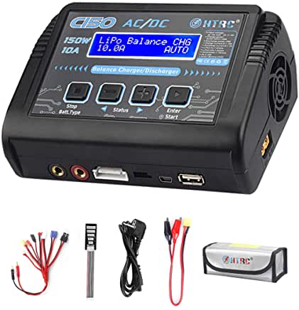

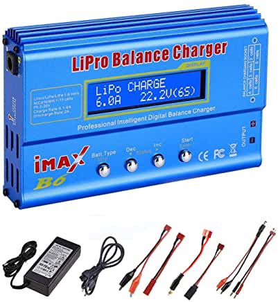

Be careful,Nicd and Li-on batteries do not charge is the same way,morevoer you need a charger suitable for both technologies :{ no question of using any charger otherwise :thumbdown: risk of explosion and fire,i recommend the purchasse,of a charger of this type :thumbup:
For charged,Nicd,Nimh,Lipo,Li-on and PB

Here’s the one I use. Love it. Has more features than I’ll ever use but it’s nice to know it’s there.
https://www.taigentanks.com/chargers-ac ... s/imx10526
It’s on sale. If you live in the USA get it now and never be sorry.
