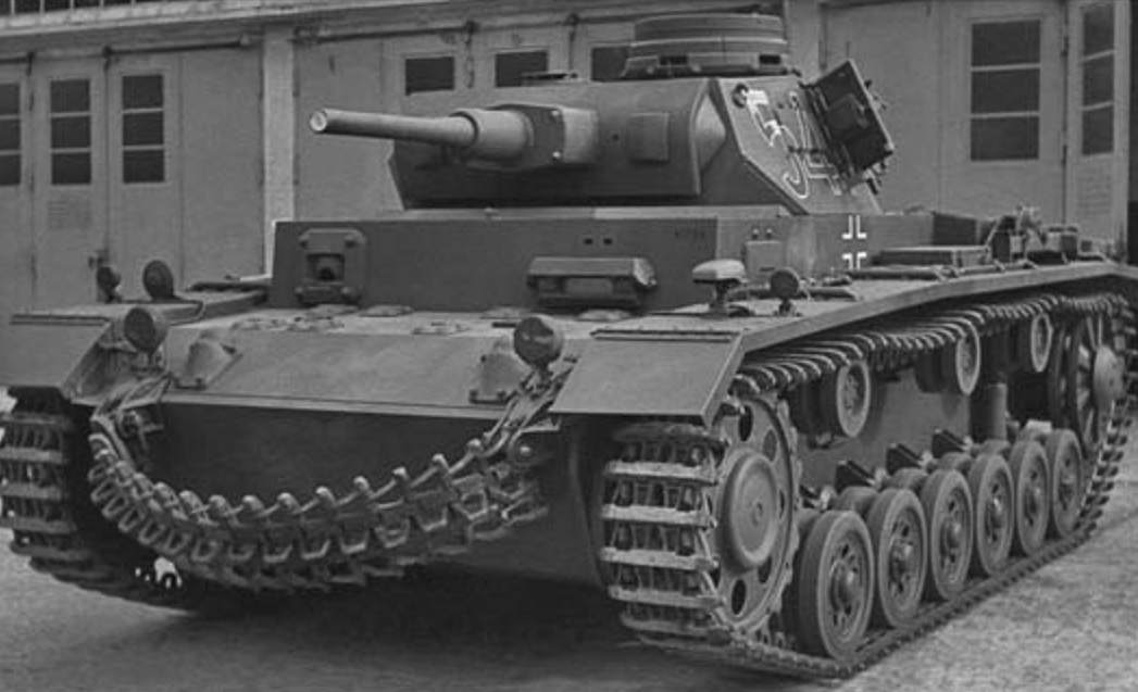

That stug like most panzer III and IV in worldwide museums nowadays have the tracks the wrong way.
You only have to see old original black and white pics to see the inmense majority of tanks have the tracks the other way.
Most of the museums have them placed the wrong way because the people that restorated the tanks had no idea about tanks. That includes using hardware store paint instead of using similar to original colors and many more.
One restored panzer IV in a museum in Spain has the tracks the wrong way as well and a friend that works there told me it is like that because nobody told the restorers how to place the tracks. Go and figure...
And uh, that tiger in your pic has one set of tracks well placed and the other inverted.

Rad_Schuhart wrote:That stug like most panzer III and IV in worldwide museums nowadays have the tracks the wrong way.
Thanks, Rad! Now show us some pics of Tanks with correctly fitted tracks :) ;) Also, tell us why they have the 'correct' orientation.
Just google "Panzer IV black and white" Panzer III will work too: https://www.google.com/search?q=panzer+ ... ChS0zoHR9M
One of the thousand pics you can find in that link:
Most (maybe all) of them have the tracks in the original and correct position, which is the opposite to that stug.
And why is that correct? That is a question for the german engineers that designed it, not for this humble worm that answers here.

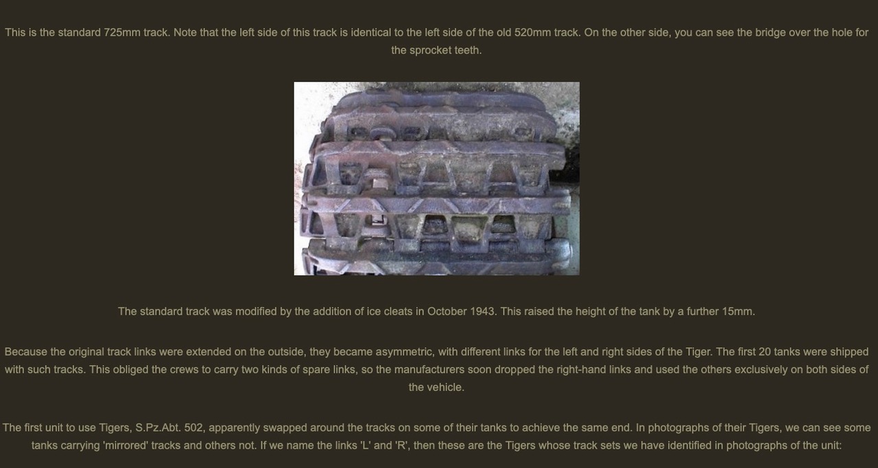

Many tracks look symmetrical, and so it's difficult to tell which should go on the left, and which on the right. Look at this one:
Symmetrical track
Symmetrical track
Symmetrical tank track.jpg (162 KiB) Viewed 3154 times
This is fitted to the left side (from the driver's view point). My query would be, should that forward-facing 'V' shape be pointing backwards on the other side, or should both sides have the 'v' facing forwards? That's really what I'm getting at.
Symmetry was the norm for most tracks, simply as a matter of expediency. It made no logistical sense to carry two types of spare track. The exception being the winter tracks with cleats.
There's a mention of the practicality issue in this piece on the Tiger 1's track by David Byrden.
http://tiger1.info/EN/Tracks.html
Byrden's take on Tiger 1 tracks
Click to ENLARGE this pic. :)
It strikes me that with truly symmetrical tracks, the only determining factor on how they should be fitted would be access to the pins; how they're fitted, locked, and removed.
