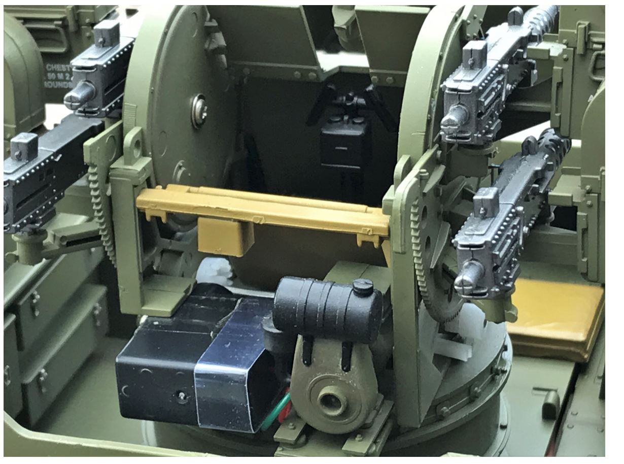

The M45 quad mount is interesting at first. But then, I became disappointed. The detail on the M2 machine guns is really basic. The builder did not align the machine guns when gluing them on the mount, so they look bad shooting in all directions. It is critical for the look that a squad weapon mount has its guns shoot in the same direction. This could be fixed though.
The mount is provided with rotation and elevation, this is great. However, it is designed in such a way that makes maintenance nearly impossible without breaking something else. When there is a failure on this thing, its probably the end of it. I guess this is why so many owners convert their M16 into an M3. I nearly have.

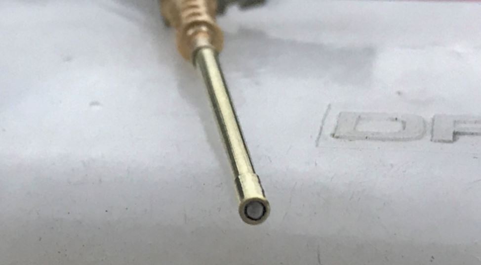

A small LED is installed in each barrel. There is a trench like cavity on each barrel that certainly show then the guns are raised.

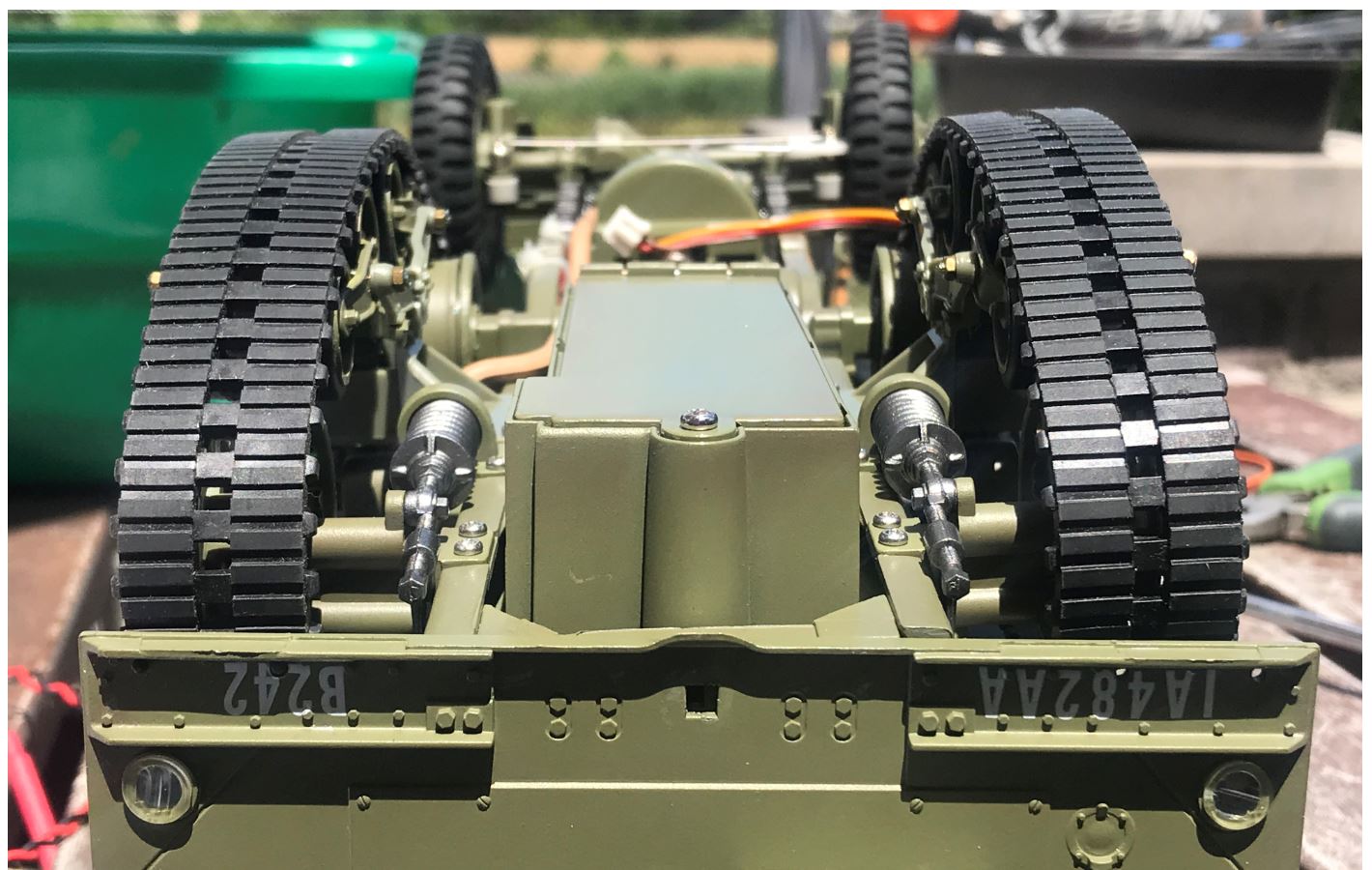

Despite all my attempts at trying to make it work, its doesn't. The emitter and binding process is good, but that board is dead. No big deal, after seeing it in action on YouTube, I made my mind to replace it anyway. I have decided to replace it with my 35RCTANK MTC-2 control board and ACU unit. As it is, I did not think this model is worth buying an expensive Elmod control board, well maybe later. For now, the task is to adapt the rest of the electronic to make it work with the new MTC-2 control board.

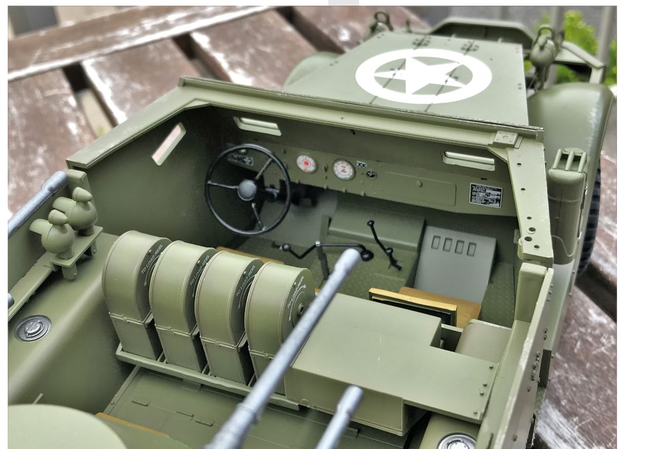

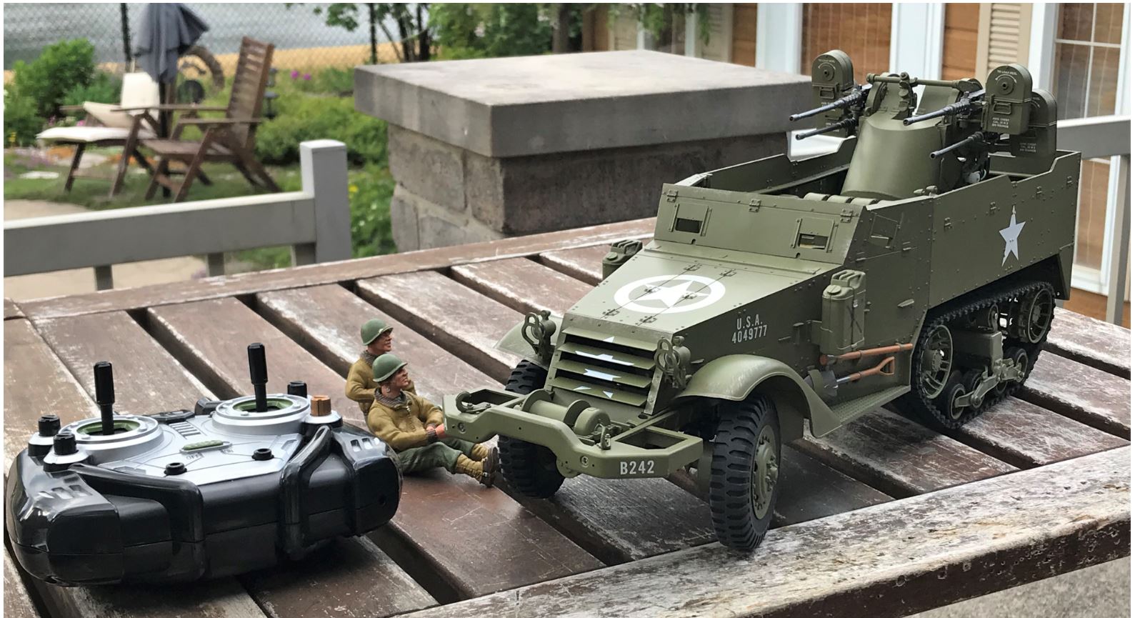

View of the front and cabin interior. I am a big fan of AFV with open fighting compartment. Although the side doors are not detailed, they can be made detailed. I was happily surprised that a full interior is possible without something major or unrealistic in the way. So, there is potential for a very good model here, with figures and equipment.
That battery box for the 8 AA batteries in the back is huge and will be dramatically reduced with the planned battery.

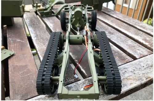

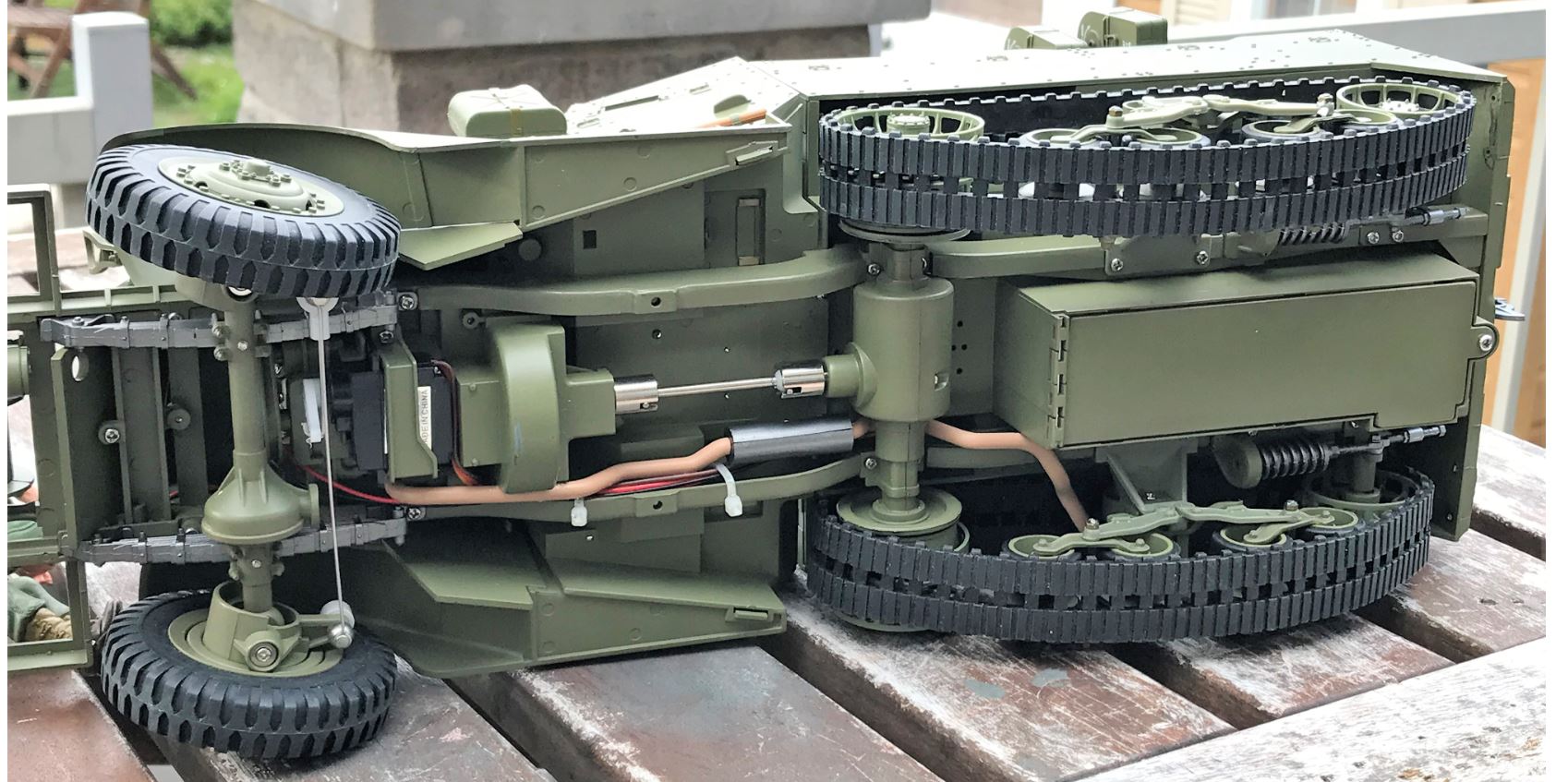

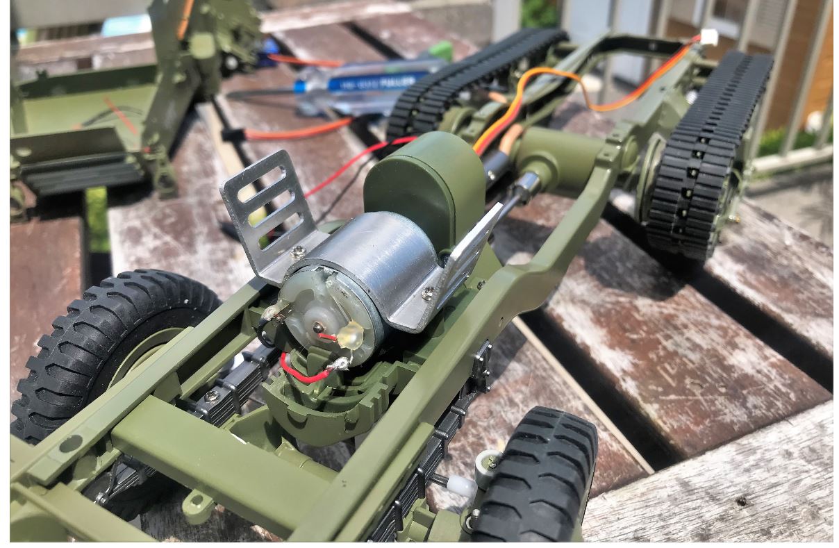

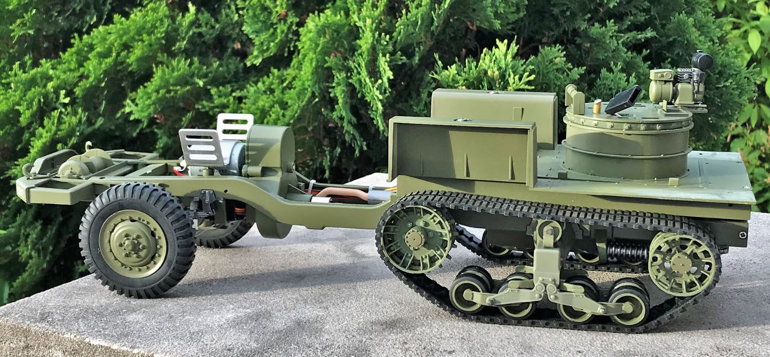

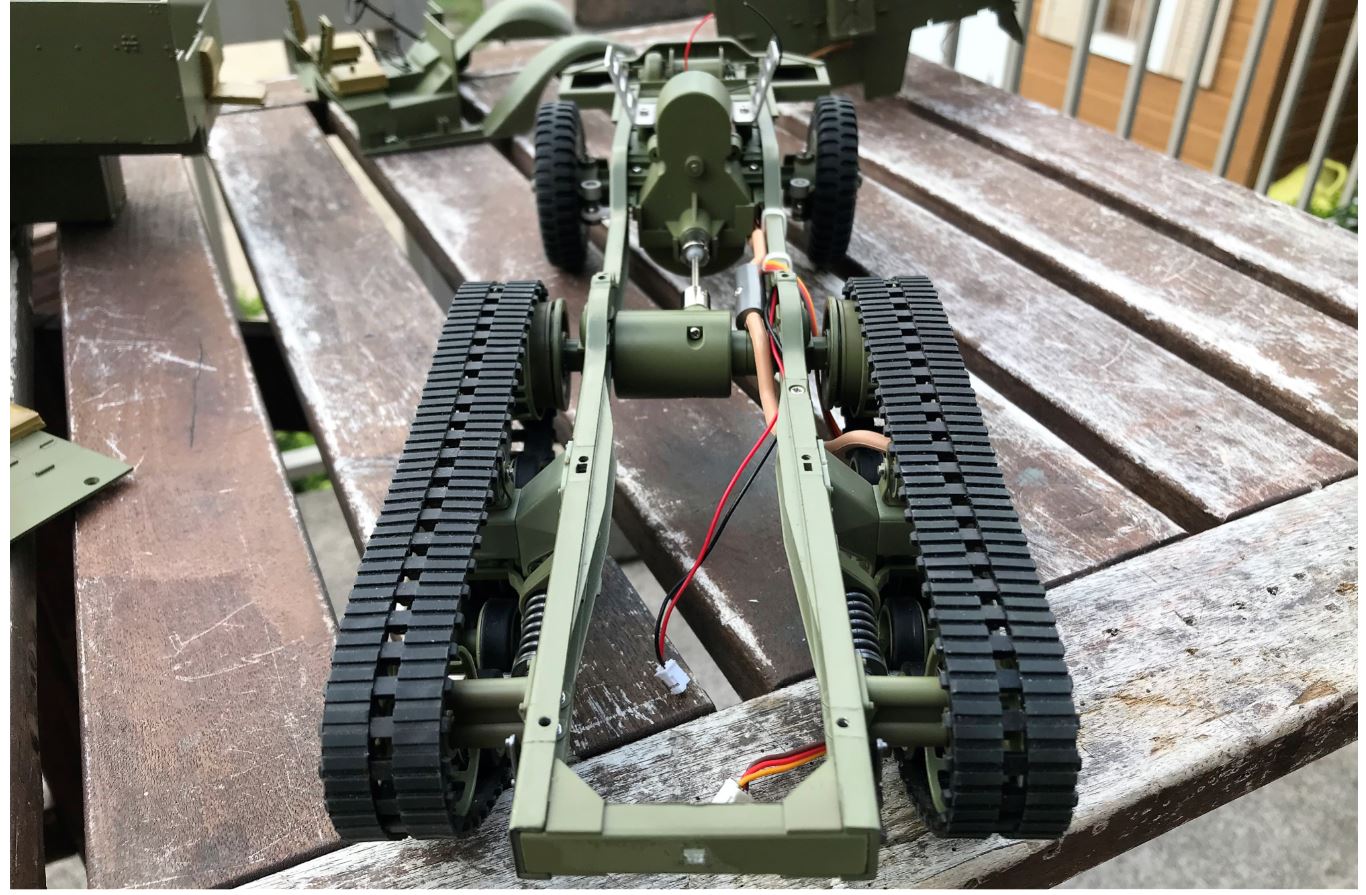

The chassis is excellent. It has a metal frame, rubber tire, servo direction, good transmission, rubber tracks and flexible rear suspension. Lots of good stuff here.

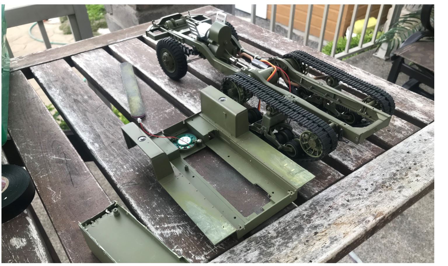

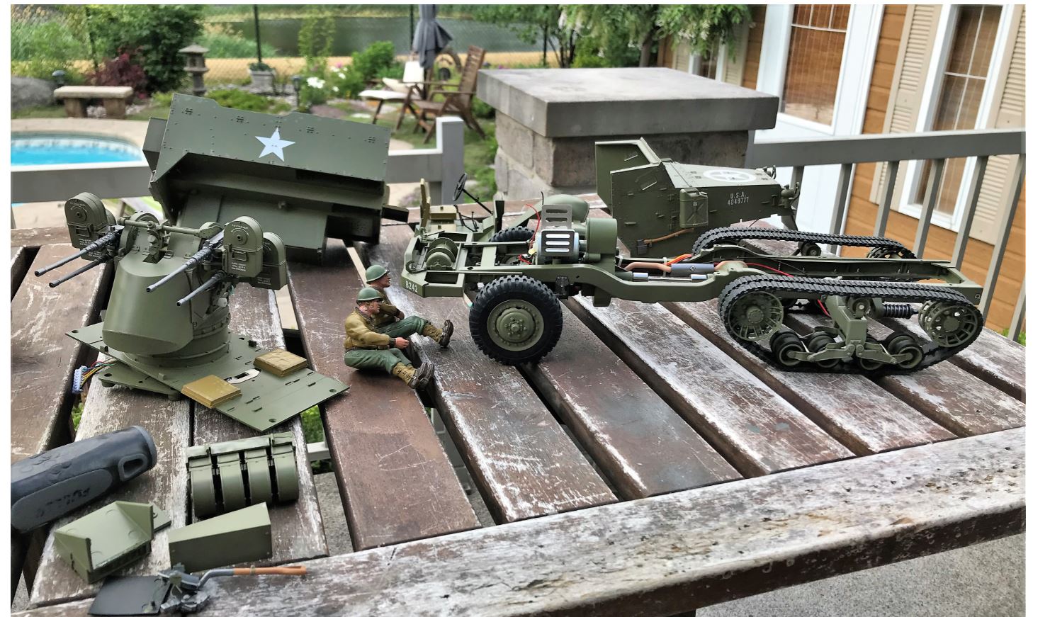

The model is being disassembled.
2 figures are provided. They are caricatural in nature, not 1/16, and looking more like monkeys that anything else. Definitely not the look I want on my model, but some body parts could be reusable.
I am pleased with the chassis.

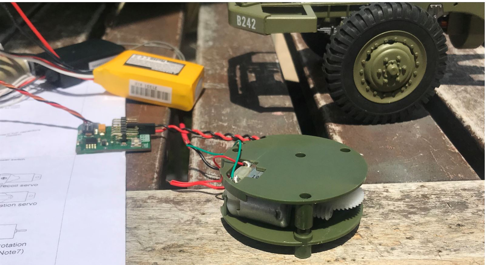

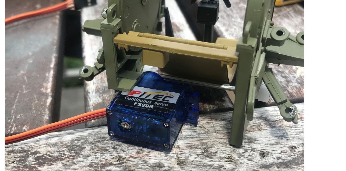

The gun mount is too complicated and fragile in my views. It is designed for continuous 360 degrees rotation, when it works...

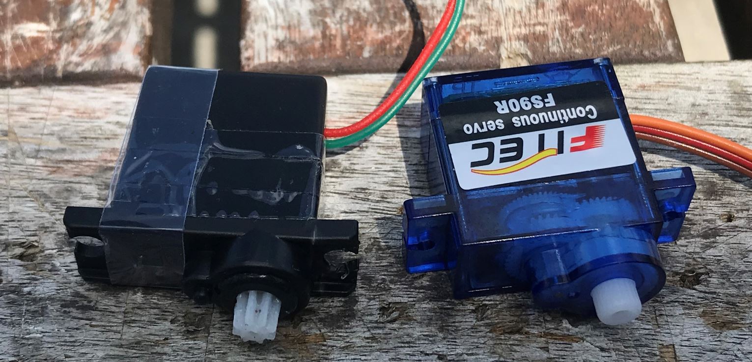

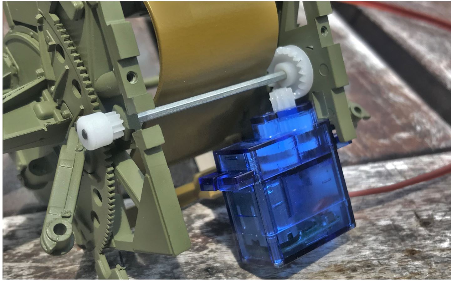

Gun elevation is provided by a motor unit exactly the size of a micro servo. I decided to replace it with a 2-way 360 continuous rotation servo that will be connected directly to the Flysky receiver on a available channel with the VRA knob.
The motor unit gear connecting to the mount elevation gear is not the same as the servo. But they looked exchangeable. So, I switched the WSN elevation gears to the servo, a perfect fit.

The gun mount now has servo elevation, and tested. Working well.
The servo fits perfectly where the old motor unit was, even the screw is reusable.

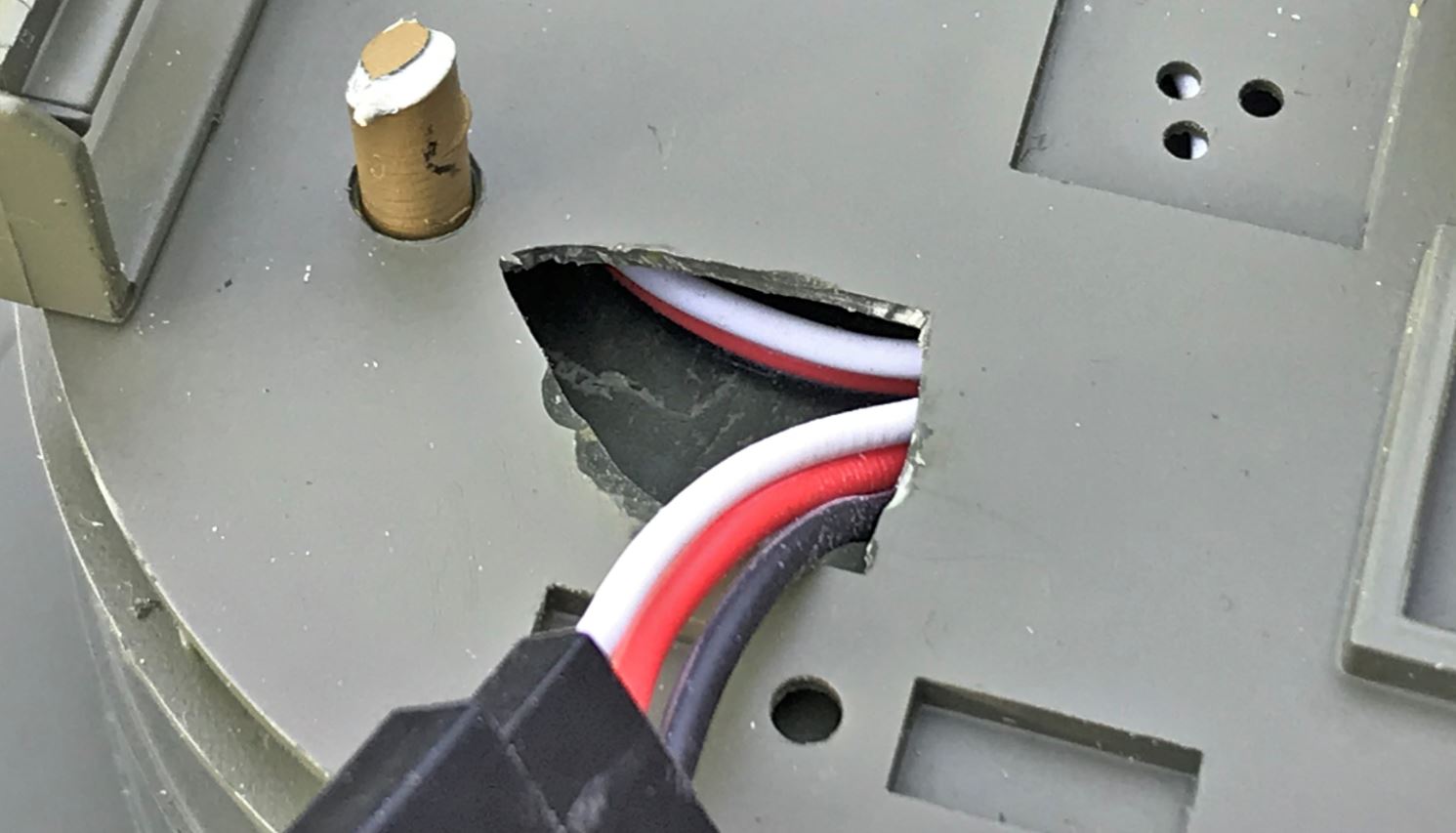

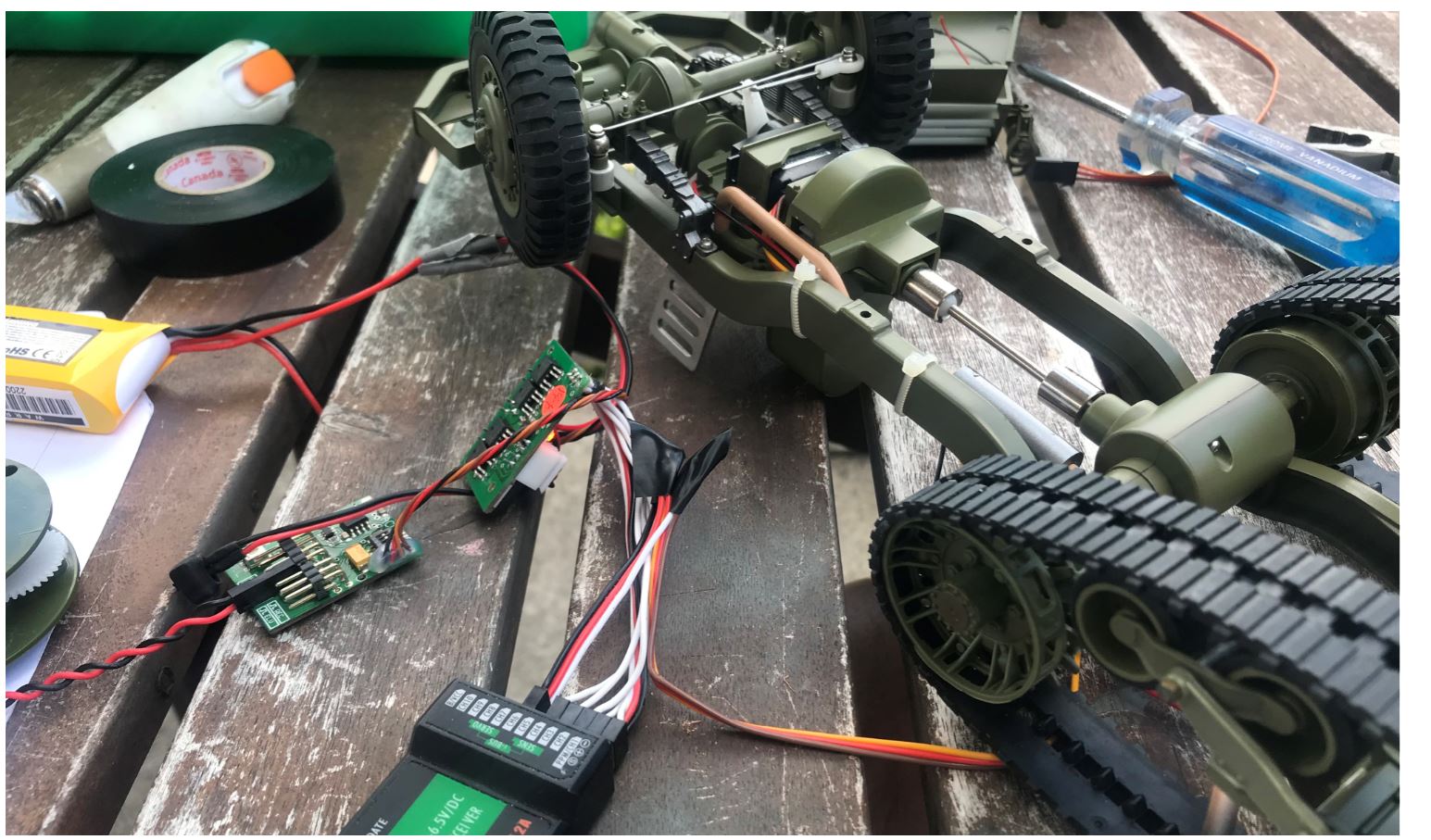

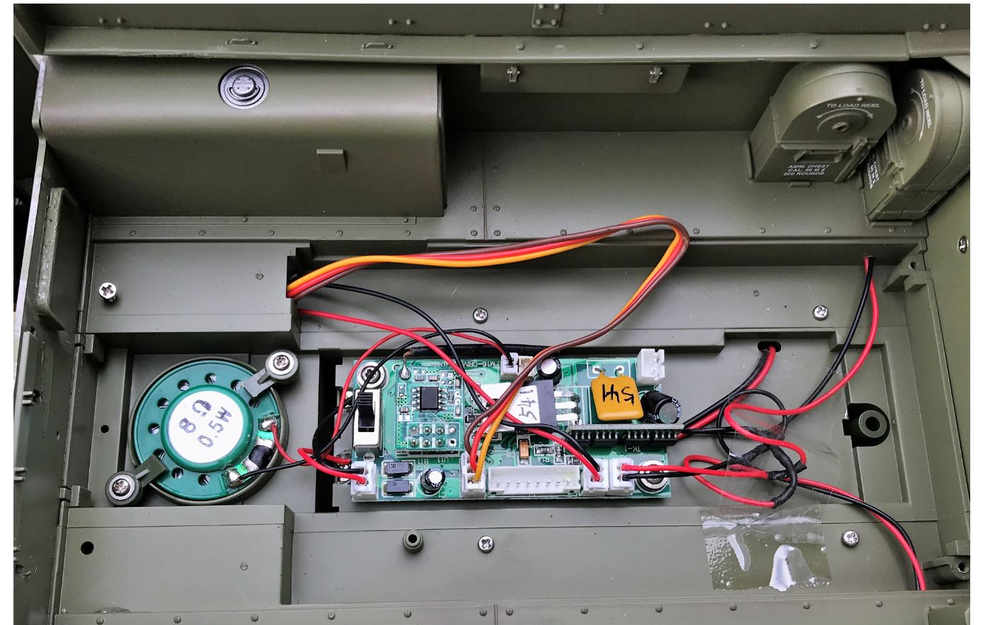

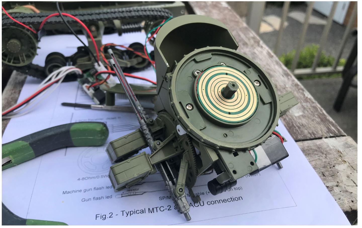

Gun mount rotation connects directly to the MTC-2 board with a new connector, and tested. Working well.
The main motor is connected to one of the engine port on the board, and tested. After changing its connector, the steering servo is connected directly to the Flysky receiver on a available channel, and assigned the VRB knob for driving the vehicle. All good. I prefer driving with one of the two knob on the emitter than a stick. Its like a driving wheel.

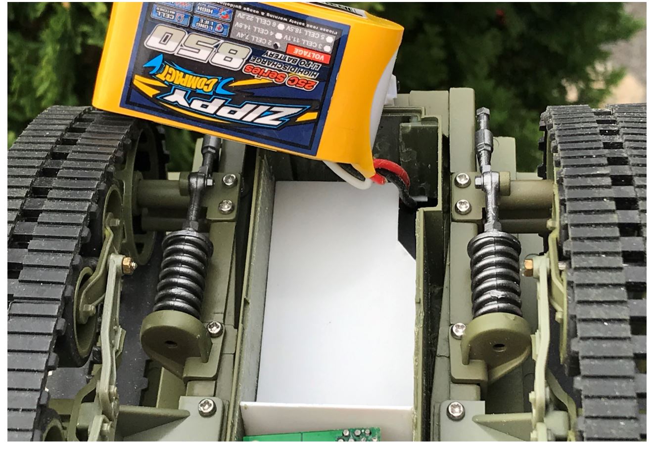

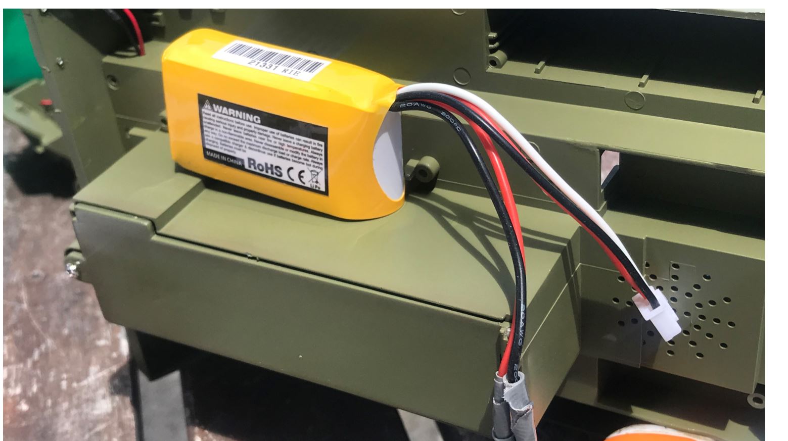

The new battery size and the needed room for the receiver will allow me to cut the former battery box in half, so it won't show from the back and side. Great !
I could not wait to remove that battery box.

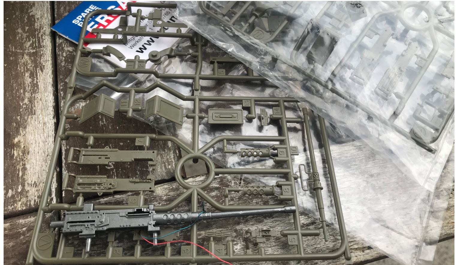

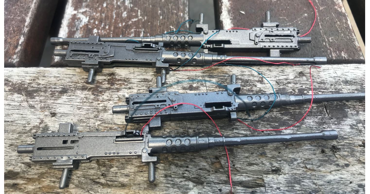

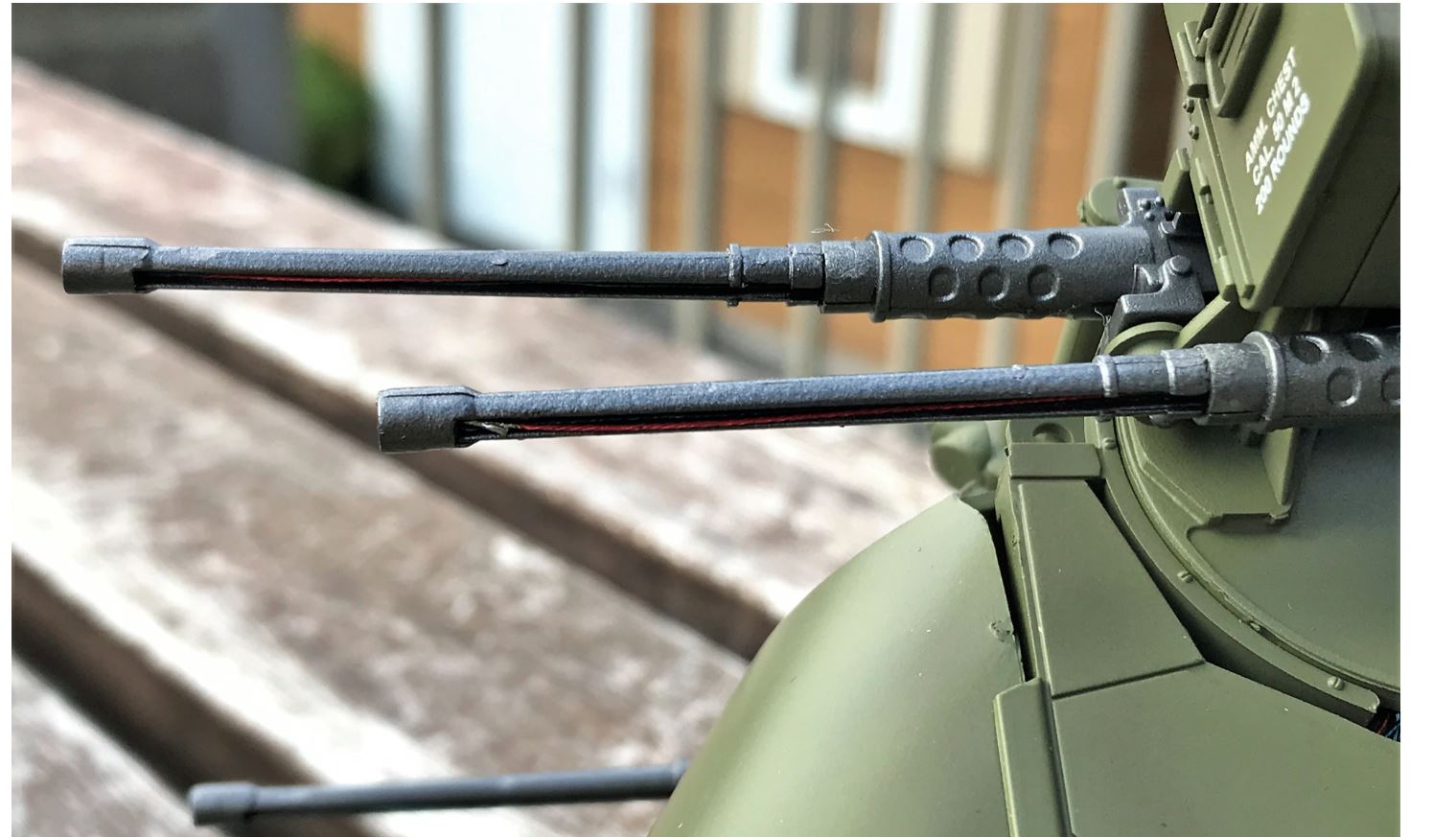

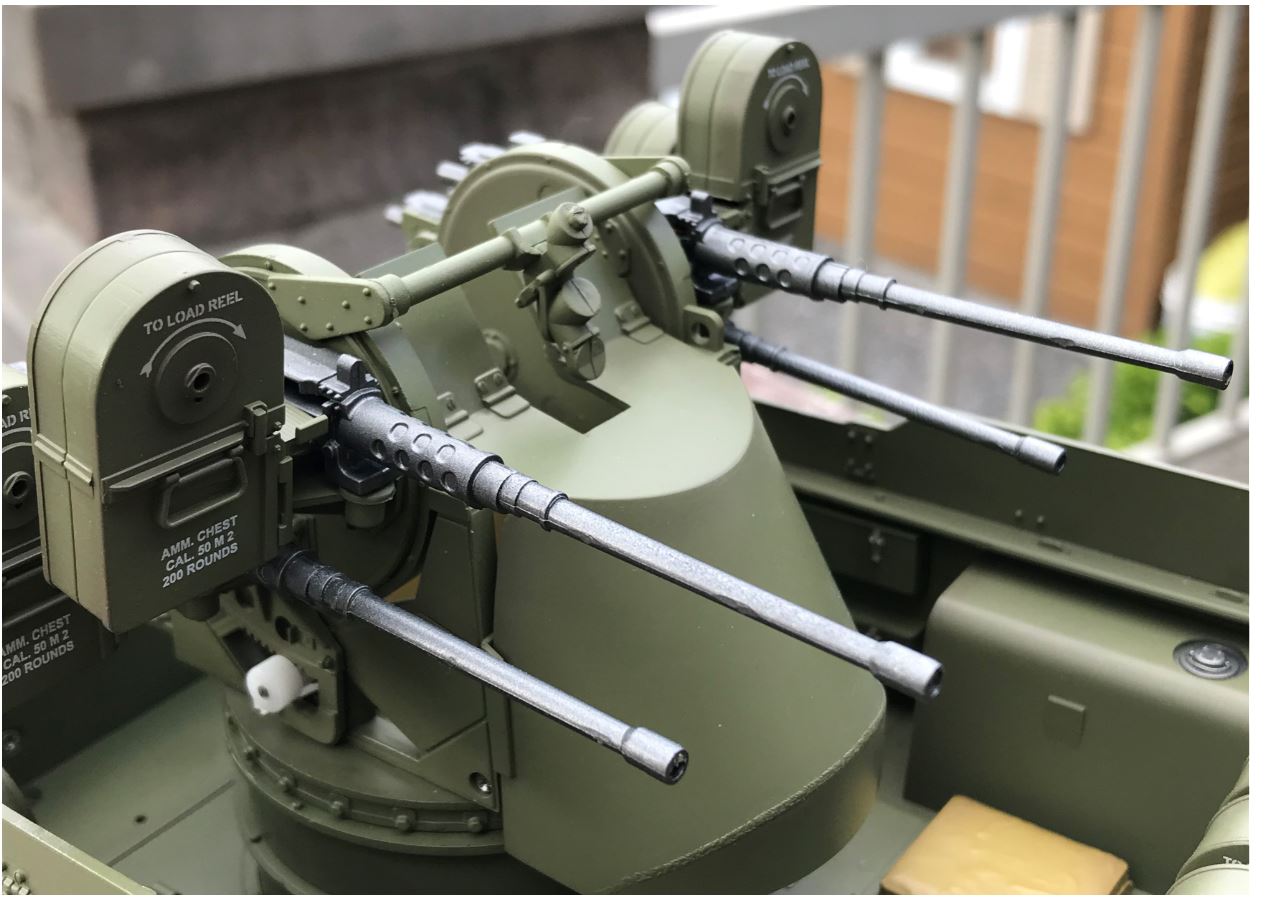

The machine guns and their LEDs will be discarded.
These will be replaced by Tamiya M2s. The Tamiya guns are a bit smaller than the WSN ones.

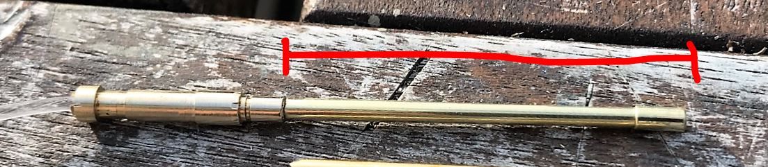

I have experimented with Tamiya M2s in the past, with the M551 and M48 build in order to give them gun flash using fibre optics connected to a good LED. I will not use ABER detail kits because it would mostly be waisted on naked guns. The plan is to simply embed a 3mm LED fully inside the body of the M2, and use a 2mm brass tube as a barrel with a 1mm fibre optic running through it, as seen below for the M551 build. It worked well. The connections and wiring though the gun mount will be the bigger challenge as I have decided to discard the 360 wheel for the connector and go with direct wiring to the control board.
Each brass tube will be reworked with a barrel appearance, and I can tell you that all guns will be aligned and shoot strait. Well, that's the plan, and I also did most of the Proof of concept, so it seems this can be a good build.

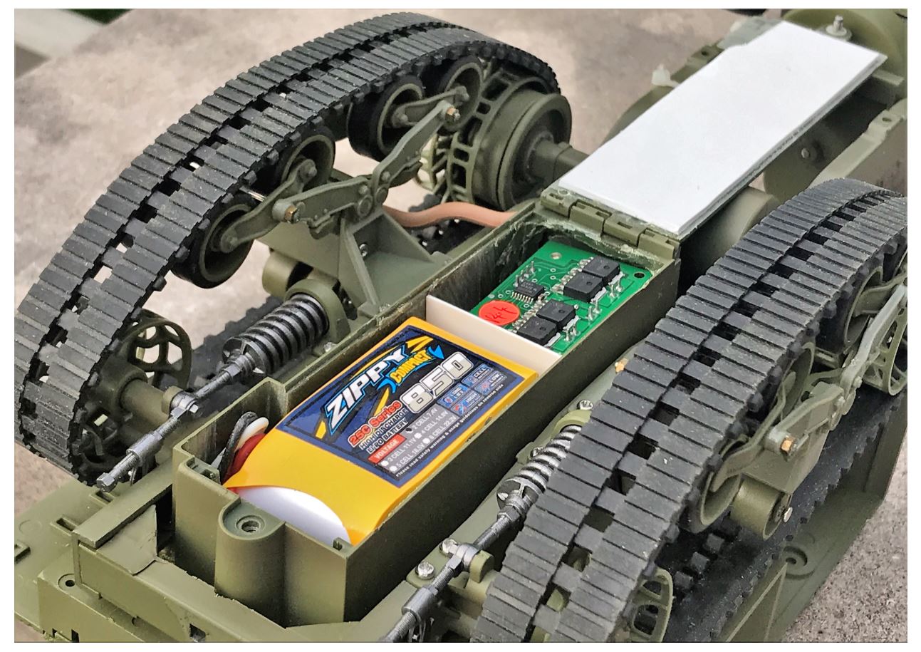

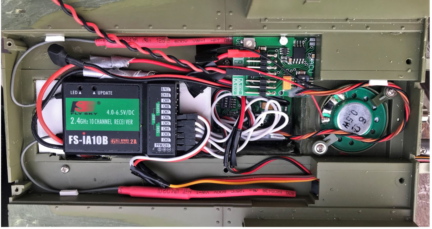

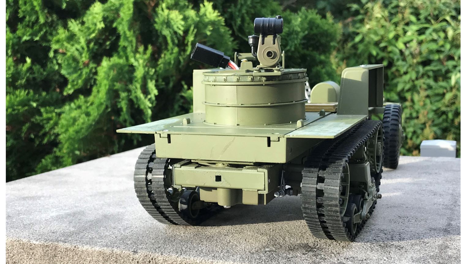

Continuing with the build.

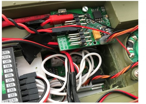

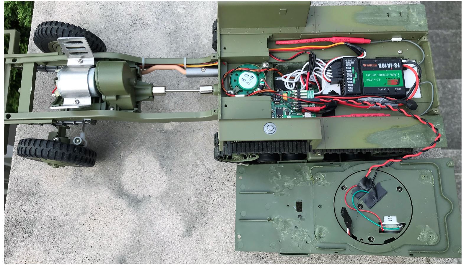

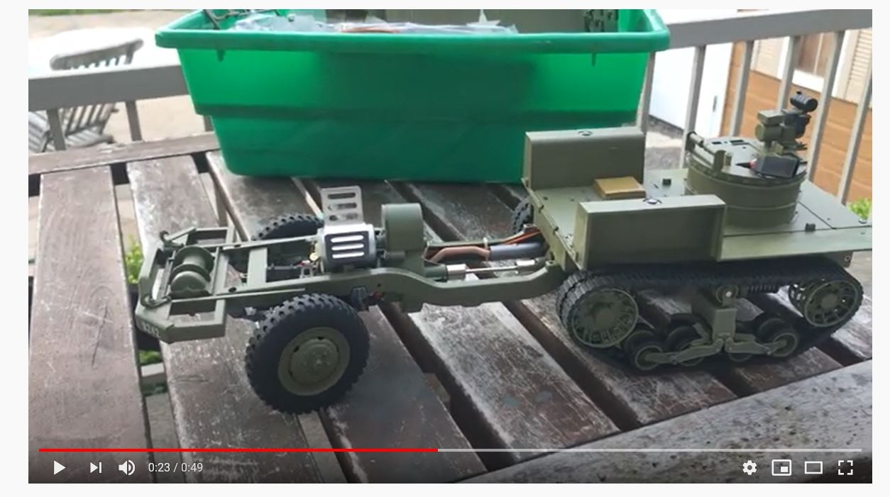

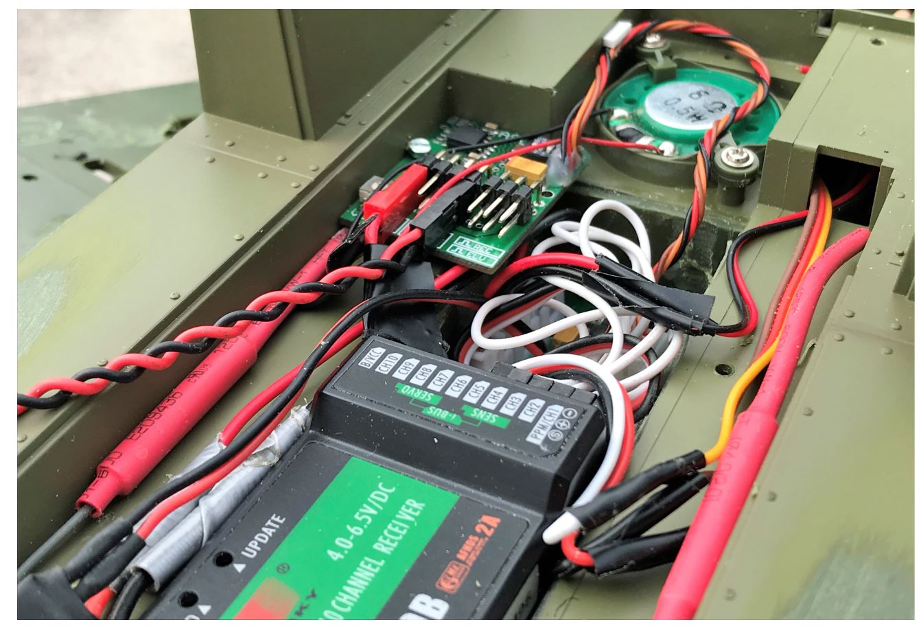

The 35RCTANK MTC-2 and ACU units have been installed and the running gear has been tested and working well.
Here is a short YouTube video of the model running with the MTC-2, minus the gun mount.
https://youtu.be/BzA9-wIm39g
One centimeter in depth has been removed from the top of the battery box, and then glued back in place. Two compartments at the bottom of the former battery box have been created and separated with plasticard, one for the Zippy Compact 850 two cell 7.4V battery, and one for the MTC-2 unit.
The battery section is enclosed so that the receiver can be placed on top of it.
View from the top. The ability to lift the lid and do easy maintenance on the electronic was important to me. When I tried that the first time to disassemble the model with the WSN electronics, I ripped two cables at the same time, the wires were so thin, short and had no slack.
Flysky 10 channel receiver is on top of the battery section on the left, MTC-2 unit at the bottom of the battery right section, ACU unit attached to the top. The WSN speaker was connected to the ACU for engine and gun sounds. Its quite powerful for its size. My wife had to tell me to reduce the volume during testing because she saw it was annoying the neighbours and their dog.
The MTC-2 unit is resting on the door of the battery pack and can be serviced from both sides to disconnect batteries and check things out.
Overview of the model.
A rear view showing the reduced depth of the battery box. It is a bit less obvious now. I wanted to remove more but decided to keep a few extra mm so that there is extra room above for all the wiring inside, a wise decision.
The rotation motor unit has been connected and can be seen in the video above. It is quite slow... Not sure if it is the MTC-2 doing that or if the speed is the same with the WSN electronic or the Elmod. It would be hard to shoot at planes at that rotation speed. In this picture. I removed all the WSN 360 connectors that seemed problematic in my case. I made about 6mm of room between the walls of the rotation gear and the bottom of the quad mount above so that a good length of cable can be let loose in there, allowing for easy rotation of 180 degrees (more actually) on both side, similar to a HL tank turret. At the speed that this thing is turning, there is limited interest to make it rotate with continuous 360s. As this vehicle is a Meat Chopper, slow turning is ok.
Next step, the gun mount and its M2s.
