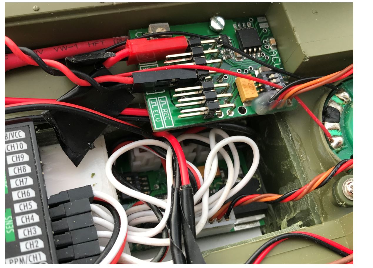

The 35RCTANK MTC-2 and ACU units have been installed and the running gear has been tested and working well.

One centimeter in depth has been removed from the top of the battery box, and then glued back in place. Two compartments at the bottom of the former battery box have been created and separated with plasticard, one for the Zippy Compact 850 two cell 7.4V battery, and one for the MTC-2 unit.
1/16 RC M16 Half Track MGMC Meat Chopper Korea build
The battery section is enclosed so that the receiver can be placed on top of it.
View from the top. The ability to lift the lid and do easy maintenance on the electronic was important to me. When I tried that the first time to disassemble the model with the WSN electronics, I ripped two cables at the same time, the wires were so thin, short and had no slack.
Flysky 10 channel receiver is on top of the battery section on the left, MTC-2 unit at the bottom of the battery right section, ACU unit attached to the top. The WSN speaker was connected to the ACU for engine and gun sounds. Its quite powerful for its size. My wife had to tell me to reduce the volume during testing because she saw it was annoying the neighbours and their dog.
The MTC-2 unit is resting on the door of the battery pack and can be serviced from both sides to disconnect batteries and check things out.

The rotation motor unit has been connected and can be seen in the video above. It is quite slow... Not sure if it is the MTC-2 doing that or if the speed is the same with the WSN electronic or the Elmod. It would be hard to shoot at planes at that rotation speed. In this picture. I removed all the WSN 360 connectors that seemed problematic in my case. I made about 6mm of room between the walls of the rotation gear and the bottom of the quad mount above so that a good length of cable can be let loose in there, allowing for easy rotation of 180 degrees (more actually) on both side, similar to a HL tank turret. At the speed that this thing is turning, there is limited interest to make it rotate with continuous 360s. As this vehicle is a Meat Chopper, slow turning is ok.
