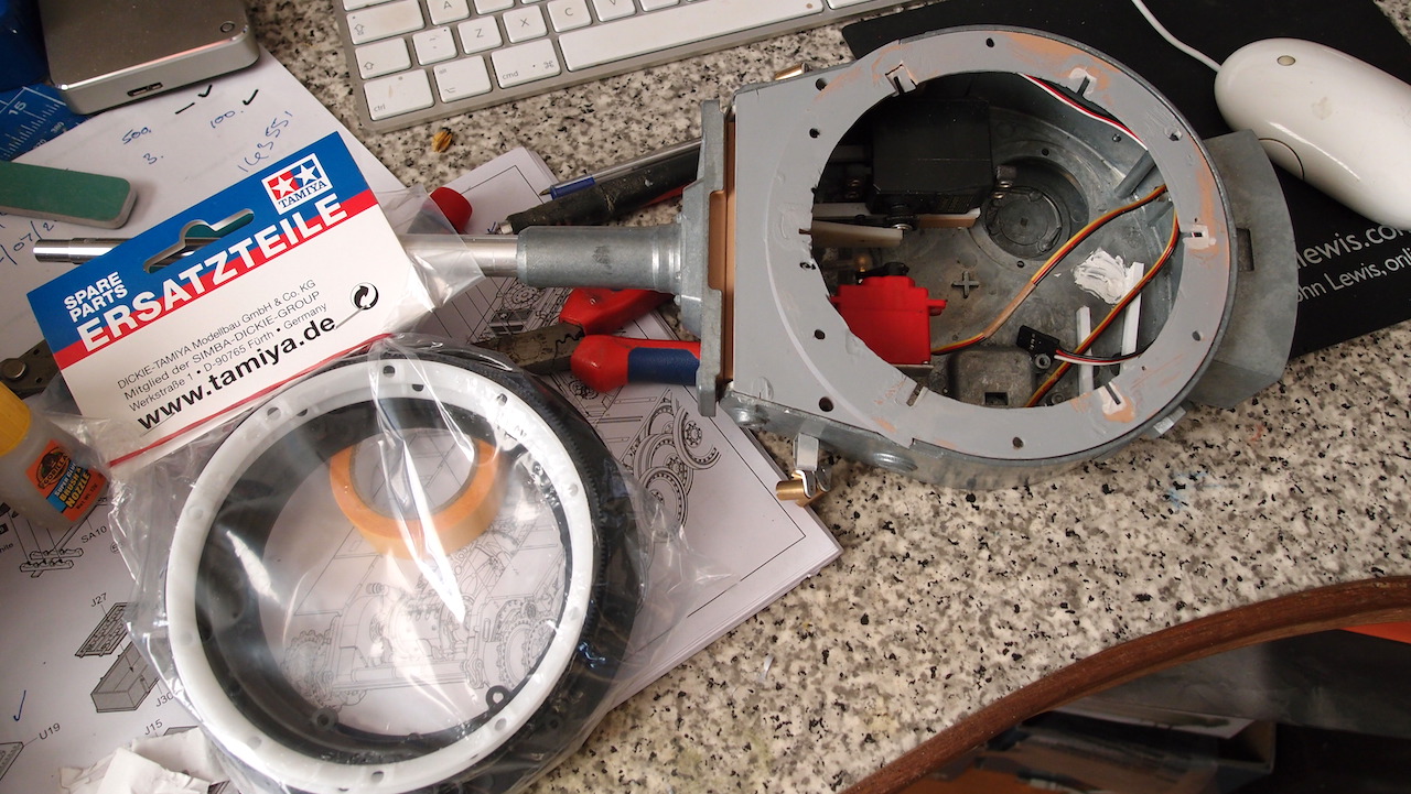

Whats the state of play with the Taigen or Hl tiger1. Have they fixed any of the issues or better just going for a Tamiya. Redoing the turret base and the hull turret opening is putting me off. Cant be bothered doing it if it needs fixed, i could use the nice Leopard unit . Problem its also a nightmare to get right especially the height in the hull and fitting to the turret as i found out doing the Kingtiger.

Perhaps you could try using the Tamiya Tiger 1 hull deck. That way, you'll have things in the right place. It shouldn't be too hard to adapt the Taigen/HL upper to accept the Tamiya deck- which is, after all, it's just a flat bendy sheet.ronnie42 wrote:Whats the state of play with the Taigen or Hl tiger1. Have they fixed any of the issues or better just going for a Tamiya. Redoing the turret base and the hull turret opening is putting me off. Cant be bothered doing it if it needs fixed, i could use the nice Leopard unit . Problem its also a nightmare to get right especially the height in the hull and fitting to the turret as i found out doing the Kingtiger.

Hi 43rd Was looking for a quick build between the interesting ones , no chopping up hulls or turrets. Done the tiger way back , a lot of the Tamiya spares are out of stock. Have one rule never order anything if its not in stock, sometimes its a good move . Never painted the underside of the tiger to remind me of the Taigen /HL pitfalls
