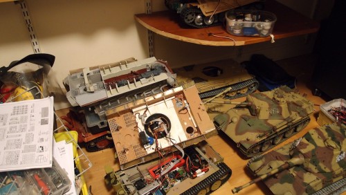

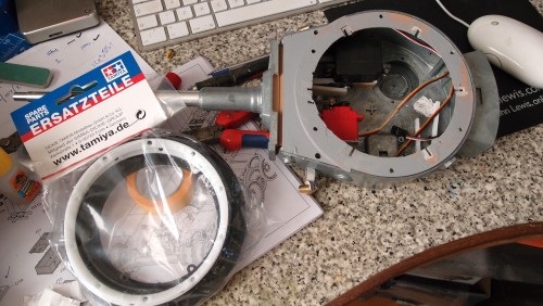

Whats the state of play with the Taigen or Hl tiger1. Have they fixed any of the issues or better just going for a Tamiya. Redoing the turret base and the hull turret opening is putting me off. Cant be bothered doing it if it needs fixed, i could use the nice Leopard unit . Problem its also a nightmare to get right especially the height in the hull and fitting to the turret as i found out doing the Kingtiger.
Turret mod ,too much work involved to finish.
