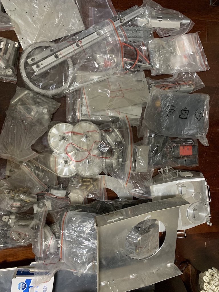

A friend in Shanghai owns one which he built as a kit from their last production so recommend you contact him. Could be several reasons from the zamac used for the links to design or damage from pressing the link pins which he discovered early on & was lucky enough to get replacement links. He decided to assemble his track using c-clips, not hammer, as they recommended & so far hasn't had any issues. That said he's found the Luchs is best suited to grass or light off road use - its not as robust as their earlier models. Was told its consider to be their worst (as well final) release, quality wise.
