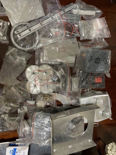

Hello to all. i have a Metalbox Panzer 2 Luchs. I replaced the wiring/electronics and it has been running great until I encountered a serious issue with the track links. They started cracking and then breaking. At first i could replace the broken links but then they started breaking more often. I am a careful "scale/realistic" operator - not a speed demon quick turner. The tank is now unusable because many more links than I have extra are broken or cracked. It would seem that Metalbox is out of business and have not answered my E mails. The only solution I see right now is the German tracks which are very expensive. Right now I have an expensive "door stop" that I have put a lot of work into. Has anyone else had this problem? Any solutions? A friend has suggested that I got a set of tracks with the wrong metal mix.
Thanks for any help
