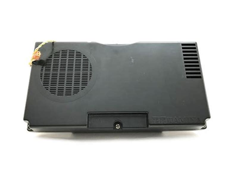

This one, for the Pz IV costs almost 70 Euros:
Tamiya Pz IV speaker
Tamiya Pz IV speaker.jpg (27.32 KiB) Viewed 5241 times

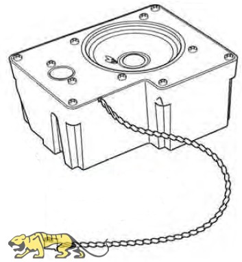

Tamiya Tiger 1 speaker (over 50 Euros):
Tamiya Tiger 1 speaker.
Tamiya Tiger 1 speaker.jpg (24.13 KiB) Viewed 5241 times
If you happen to build a Tamiya tank from a static model (when available) using another make of speaker is always an option. But, is it the right option?
Similarly, the internal spaces of Taigen and HL tanks are- for obvious reasons- roughly the same as those of Tamiya models, and so fitting Tamiya speakers to non-Tamiya tanks could be an option (notwithstanding
swapping out electrical connectors, disparate power needs, etc...). But, would it be worthwhile for any possible improvement in sounds? i wonder. :think: :D

Hi, now you mention me... You all know I am very critic with Tamiya... But I must say the speakers are good, very good. But I don't think this is because of the quality of the speaker itself. They are good because of the resonance box. The bigger the box, the better the sound and better the bass.
But 70 Euros? Nope, NO WAY. For that price I can buy two decent speakers with a nice subwoofer for my computer, lol.
So yes, if your tank arrived with the speaker and you have room for all the electronics, Id use it.
If I had a tamiya tank that came with no tamiya speaker, id try to source a speaker with similar specs and to handmade an enclosure for it as big as possible for a minimal fraction the price.
That guy having problems with two speakers... Well, I dont have the numbers on my head, but each of those speakers can be feeded with up to 5W, and the benedini Mini has an output of less than 2W, so it does not surprise me it does not work well. And also I think it is just stupid to fit two speakers.

Hi you can pick up Tamiya truck speakers a lot cheaper they are also smaller so fit in panzer 3 easy,you can get the truck speaker box and fit your own speaker in these cost around £10.

speaker enclosures £10 to £25.depending on size and whether you choose it with or without a "Visaton" Speaker.

I use the KV1 speaker from Tamiya - it is identical to the panzer IV one and half the price...
Re: How good are Tamiya speakers compared with the competiti
Ad Lav wrote:I use the KV1 speaker from Tamiya - it is identical to the panzer IV one and half the price...
A good tip, Adam :thumbup:
