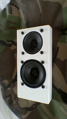

I follow the same principal as tao,i make boxes out of plastic sheet and give them a go.
If you look at my kv1 and panther thread in the heng long build section you will see some speaker boxes i made to fit the available space.
This is one i've just made for a tamiya tiger,it has an fr8 and an fr7 in it.
- speaker.jpg (41.33 KiB) Viewed 2874 times
- speaker2.jpg (69.92 KiB) Viewed 2874 times
