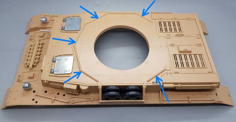

a simple swap is not possible.
There is a modification neccesary, you have to remove the blue arrow market parts:

But will the turret rings match up after I have removed those parts?

I made a panzer IV Schmalturm if you have a look I did it with a panther F turret and only thing I removed was what jhamm said

Mine was on the the taigen panzer IV with metal tracks but the upper hulls are the same only difference is that mine didn't have the extra wheels like the Torro one
