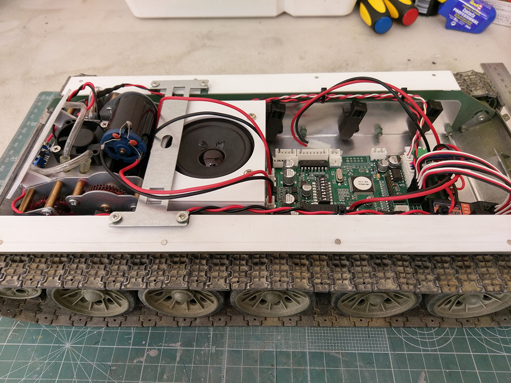

The T-34 doesn't have as much space as the German big cats, but you can still fit everything you need in one.
Here's mine with an IBU2, Tarr smoker, and gigantic Visaton FRS7 speaker.
  • Image
And here it is as it stands now, with an Elmod Fusion Pro in place of the IBU.
  • Image
Carl has also fitted one with an OpenPanzer TCB and all its attendant electronics, but that would require a smaller speaker.
