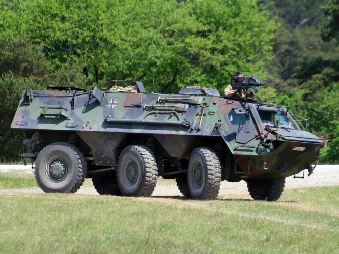

I have seen the 6x6 conversions using a pass through drive shaft on the rear axle, am I correct in thinking that the same can be done on the front axle steering axle, to allow a double steering set up?

Looking at it, I think it will work the same, only issue is getting the steering round but should be possible.

Post by wibblywobbly »
Cheers Tom, much appreciated. :thumbup:
Thinking of one these

Re: Steering axle pass through?
Post by silversurfer1947 »
Will you bother with the progressive steering to top the second pair of steering wheels crabbing? Should be fun.
Of course, I like a challenge. :think:

I will try a Morris Quad first as that is a straight bodyshell. To get 4 wheel steering I'll need to buy another truck, plus an axle plus other bits, but they are all very cheap.

Posts: 4929
Post by tomhugill »
Progressive steering should be fairly straight forward, using a shorter "lever" or servo arm depending how you want to go with it. Something like that would be far rob. I'm liking the idea of two motor drive several have adopted.

wibblywobbly wrote:I will try a Morris Quad first as that is a straight bodyshell. To get 4 wheel steering I'll need to buy another truck, plus an axle plus other bits, but they are all very cheap.
No need for another truck, you can get all the parts separately on aliexpress just search WPL

Hi Rob you can buy the axles at Banggood https://www.banggood.com/WPL-B-1-Front- ... rehouse=CN
save a bit of money buy all the axles you need .
