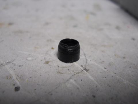

I think it's fixed!!!
I took it apart when I got home, tried to find a photo of where the (rubber grommet, bucking, whatever we call it) went but found no good photos.
1st try I put it over the end of the plunger, put it back together, turned it on...nothing came out.
Then I looked at a regular airsoft image and it showed the bucking actually over the end of the barrel. It seemed too tight for that but I took it back apart and put the bucking over the barrel.
Put it back together (getting good at this and nothing to lose at this point
), turned it on and fired...6 BBs came "screaming" out. Actually 3 came out good and the other 3 kinda rolled out the barrel. Maybe it needs a squirt of silicon???
Here's a photo of the "bucking":
Re: My Pantiger Ate All My BBs!!!
I'm able to fire the gun now, but how many BBs come out is anyone's guess. I get 2-3, then none, then maybe 1 out of 4 shoots like it should. I need to search the forum to see if other's have had this problem.

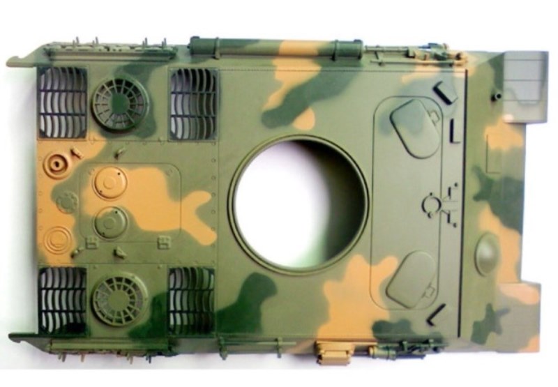

Here's a photo of my work in progress "Pantiger":
Need to dirty it up a bunch, but I'm already dreaming about turning it into a Jagd-something
I thought I'd at least try to swap the roadwheels around so they would look more correct, but I haven't found a good way to do it yet as the outer wheels won't go behind the rear idler wheel. I suppose I could shim out the idler wheel, but I'd probably need a longer screw for that.
Oh...the dark yellow was from a gallon of latex house paint I had made up at the local hardware store years ago when I was building 1/6 tanks. The red is actually Boxcar Red from my model railroading as well as the green, Pullman Green that is. Maybe I'm just trying to make the "Pantiger" even more of a fantasy tank

Can only be a Jagdtiger - its too wide to be a Jagdpanther and too big to be a Jagdpanzer.
And stating the obvious, the hull should just bolt straight on.
Yeah, the width (and the front end, etc)
It was only $85 (he says in his best model railroad rivet counting voice) and if you squint real hard it does at least appear to look like a tank so...
It may become a gift to my grandson, he'll think it's cool.
