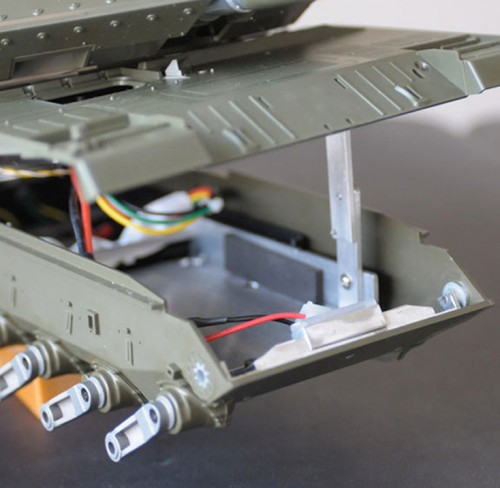

Recommended aftermarket parts for the Tamiya Leo 2 and these are the parts I used for my build.
The kit tracks are used, they run great, the metal tracks add to much weight and wear and tear to the drive train etc in my opinion.
• Tamiya Battle Unit.
• Tamiya Stabilization Unit.
• Tamiya detailed main gun metal barrel.
• Impact metal suspension arms, a must have: http://www.mitosal.com/Leopard2A6.html
• Impact road wheel bearings: http://www.mitosal.com/Leopard2A6.html
• Impact metal idler assembly: http://www.mitosal.com/Leopard2A6.html
• AFV metal turret baskets (did not like or use Impacts parts): http://www.afv-model.com/4711shop/index.php?cPath=2_4_8
• AFV small metal handles: http://www.afv-model.com/4711shop/index.php?cPath=2_4_8
• Important: Nicely routed turret wiring.
• Note: If you spec the Tamiya Gun Stabilization Unit, Tamiya USA still recommends using a Futaba SkySport FM RC Radio Transmitter (with left self-centering stick option) and Receiver.
Why?
A 2.4 rc radio will not operate the Tamiya Stabilization Unit.
I built this kit several years ago and still have the model, a favorite. You can find my Leo 2 project under Tamiya Builds, Pcomm1 here at rc tank warfare.
Enjoy!
John

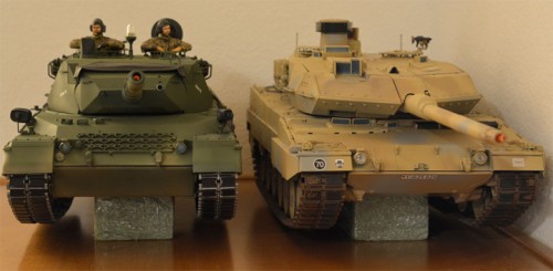

For my Leo 2 build your UK mate's posted advice would have not been very helpful and they are writing more like saboteurs; actually.
The Impact Idler Adjusters work great in my Leo 2 and provide for fine track adjustment setup when tuning your model.
As a side note: I tried the Henntec idler setup in my Leo 1 build paired with Kenny Kong Leo 1 metal tracks and the Henntec setup is to weak (not strong enough) to hold the idler adjustment tension. The Henntec idler system does work fine with the Leo 1s kit tracks, but then so do the kit's idlers.
Per my build experience and use, the Impact metal suspension arms are quality parts and work as they are supposed too.
Find my Leopard 2 here: http://www.rctankregiment.com/rctankfor ... =30&t=2247
Enjoy,
John
