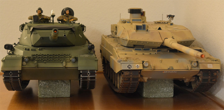

My pair of Leopards.

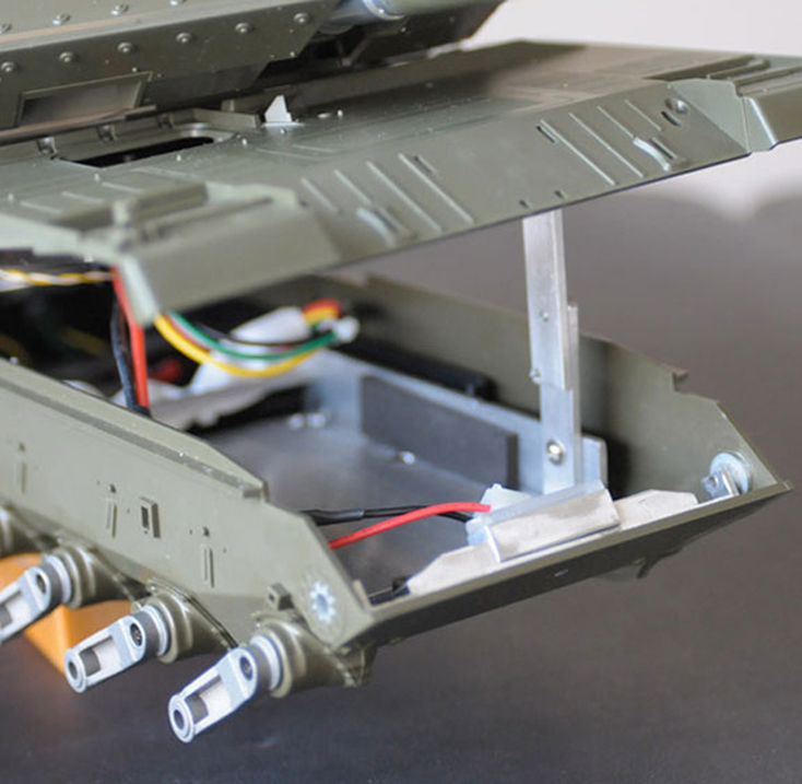

Impact suspension arms, great working parts.
