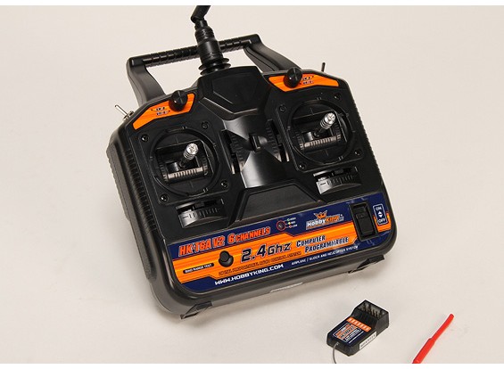

You can use one of these...... Closest thing to a Heng Long/Taigen handset.
https://hobbyking.com/en_us/hobby-king- ... ode-2.html

Hi there. A Clark tk22 will only work with a hobby grade radio. The Heng Long or Taigen radio will not work. Image
Re: TK-22 install on a pershing
You need a minimum 4 ch hobby grade radio like Michael C has in the picture
