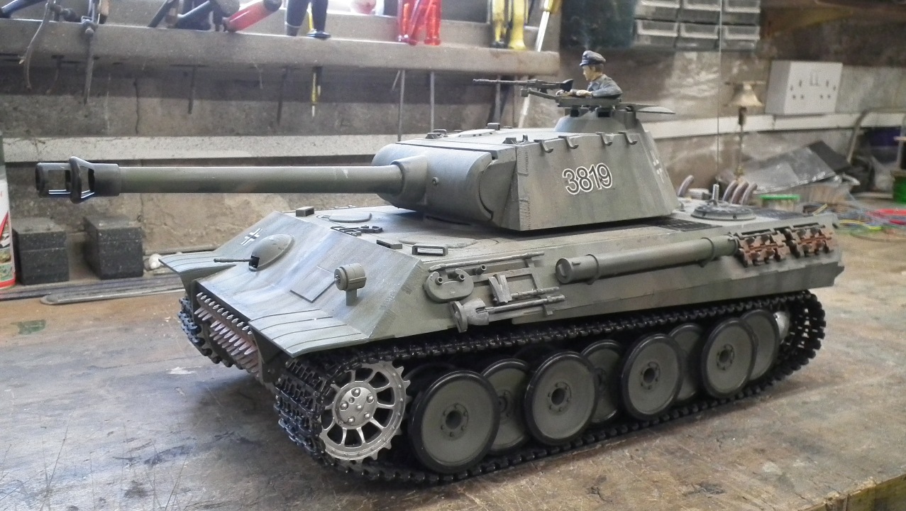

Re: How do I open these things?
Hi mate
your not the only one to have a pantiger.
Its been in my procession for a few years now and has never given an once of trouble, still running on a rx13 board.
As been said 6 screws hold the top on.
Numerous people have adviced me to ditch the top and turn it into a tiger, but to be honest as long as she keeps going I'm going to leave it alone,(as the saying goes "if it ain't broke don't fix it"
Denzil

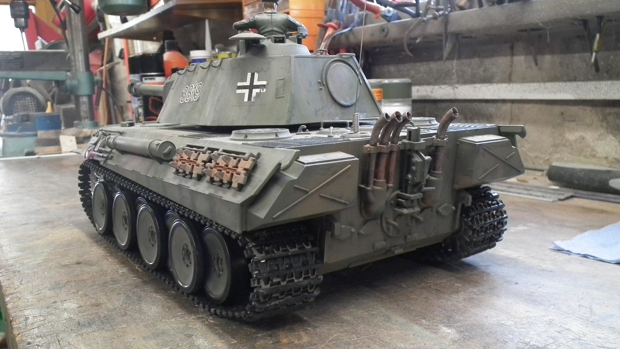

Your Pantiger looks great. yeah, don't fix it if it doesn't broke. I did a bit upgrade on my Pantiger but never convert it to a real tiger. I moved the on/off switch from the bottom to the rear because I hate to flip over the tank to switch it on/off. I also add a charging port at the rear so that I can charge the battery without removing the battery. There's a vital problem on my Pantiger, if I run it on uneven surface, the right track will surely throw off. I've been looking into this issue for a long time but never really resolve it.
Hi
Not had a problem on the Pantiger, but on an early HL tiger, it did the same. I took the rear idlers off and fitted a small washer behind it (about 0.6mm thick) it bought the idler in line with the tracks better and also greatly reduced the "wobble" in the idler, had no problem since.
I did exactly what you do. I even use a pair of Mato's metal idlers with ball bearing. but things never improved.hawkeye3guns wrote:Hi
