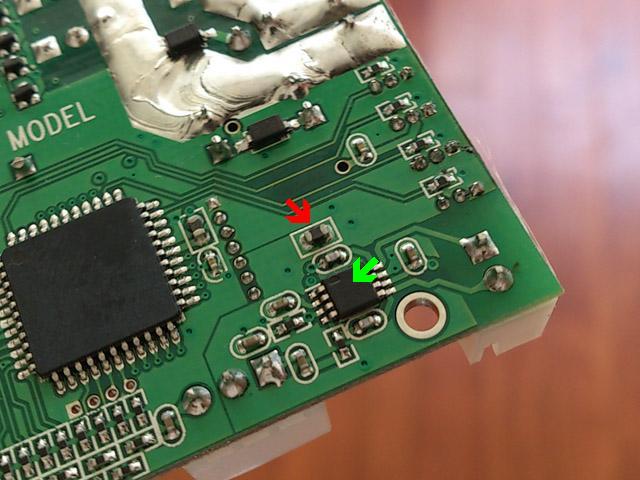

Maybe you can show me which the speaker AMP it is on the Clark board ?

From the Clark website.......
Q: I accidentally shorted speaker wire and now had barely any sound, everything still works but hardly any sound.
A: A FB( pointed by red arrow) might be damaged because of over current, please remove it and short its two pads by solder or wire. Of course, It's the best if you can find a 200 ohm FB and replace the broken one.
2nd, the audio amplifier ( pointed by green arrow) goes very hot when operating, do not apply glue or double faced adhesive tape on it and left some space for it for heat dissipation.

Hey, Is the amplifier replaceable by an other one or not ?

I wouldn't try it. I tried soldering the FB together once as per instructions and didn't work for me, not to mentioned the amp. If you don't want to send it back for repair you can try using an external amp and see what happens. There are examples of wiring and external amp on the website as well right after the low volume FAQ that I posted here.
