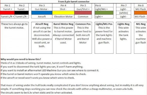

It seems to me that the lights/mg have been soldered to the wrong terminals at the factory..or in some later refit. Have a look at this:
On the right you see the MG and Lights share one common link (pin 6), but are otherwise separate. So, it looks like these are the terminals to check..if you're up for it. If not, insist (it's your right) on a replacement without
dyslexic wiring (apologies to anyone with that condition). That's: a replacement tank, not replacement BS >:<
