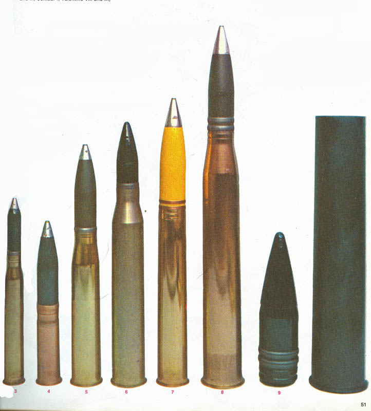

Thanks Herman and Jamie for the info :clap: :thumbup: , I was looking for length and diameter of the shell cases as well, as looking at some of the pics the shell cases look as though they are larger diameter and have a slight taper - anyone have that info please? ???
Many thanks
Alwyn :thumbup: :wave:
Posts: 11895
Re: Dimensions for 88mm PAK43 shell
Pak 43 on right
Very pronounced taper.
It really looks like a .243 hunting cartridge !
The 2-part JT ammo is on the right in the second picture.

This is a pic that I will probably work from, it looks like a 1/35 model judging from the amount of detail, and the shells shown look like the JT ones that have a larger shell case diameter than the actual shell.
As they will only be in the ammo lockers then I don't think it will matter if they are a few mm out, so I can take an approximation.

PaK 43 ammo is the 88X 822 as shown in the top picture.
Your machine has no bearing on the JT ammo. I just included a pic as comparison.

Thanks Herman that looks like the one comparing to the model pic I posted. As an approximation I would say the shell case was 110mm diameter which should do for modelling purposes.
