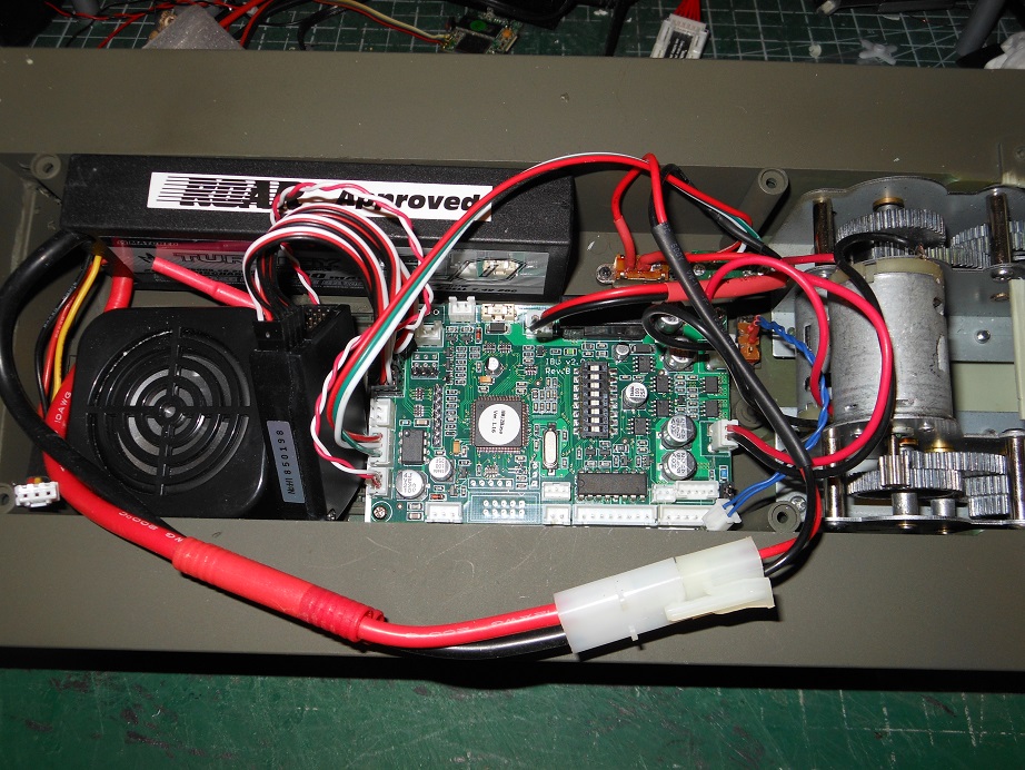

This is my Heng Long Sherman lower based Firefly with the IBU2 in it. I have since move the speaker up and have added a TARR smoker. Don't know if this would help:

Thanks Michael but the Mato lower has these stupid parts of the suspension that come through the hull and are locked in by metal horse shoe looking parts. So because of this an IBU can't fit next to the battery even length wise. Which is why I'm stuck. But thanks for the pic man!

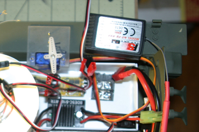

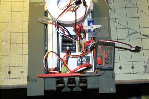

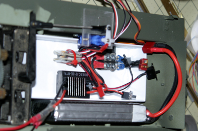

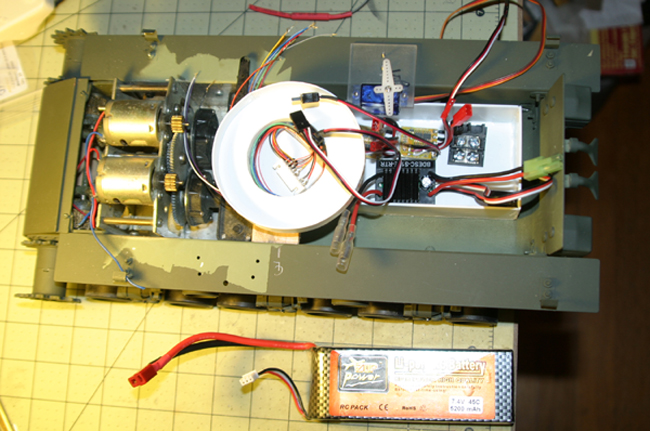

By now you probably have the M36 all squared away. Have you thought to place the battery above the fender area? There's some usable space there if your not using a high output lipo. A friend of mine with an old Tamiya M4 with a custom drive he built was forced to put his battery above the fender.
My old Tamiya M4 with the clutch drive doesn't have much room inside. I have the 9 channel Flysky RX mounted on the fender near the back of the hull. I know you want all the bells and whistles. I built my M4 very inexpensively and everything has its own ESC to control it. Granted my Old Tamiya doesn't have any thing from Tamiya inside the hull except for the drive unit; it also doesn't have sound or smoke either. Just basic functions and it also has a 360 degree turret M51 turret with an airsoft gun in it.
The tank has servo gun elevation, 360 and beyond turret rotation, and three ESC's. One ESC for the drive, one for the turret traverse motor and one to operate the airsoft guns motor. It's a very unorthodox build to say the very least!!!LOL
To be honest, I should have gutted the old clutch drive and bought all new Tamiya electronics and brought the tank into the 21st century, but it was a fun project.
If you have the time here's a link to the build on rcgroups: http://www.rcgroups.com/forums/showthread.php?t=2412393

Re: Little help please.
The strange partially visible round white upside down double layer cake thing is so the turrets slip ring wires won't get caught in either the clutch drive or the turret traverse motor. Yes, I have an excessively large lipo in there as well.
