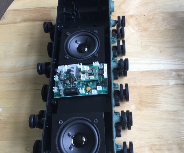

Ive been collecting parts for a few weeks so made a start on the kv1 over the w/end.
First job was to clean out the hull and sort speaker positions and mounting plate for the ibu.

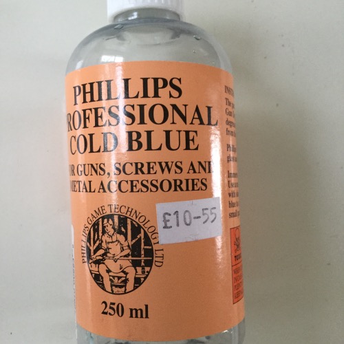

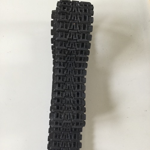

Spent an hour this afternoon working on the tracks,I used the gun bluing technique detailed in the tips section but this time used a different bluing liquid to the birchwood casey super blue.I used this alternative purely because it was cheaper and they stock it in my local gun shop.

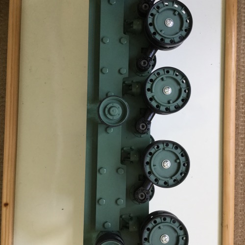

Finished off lowering the return rollers this morning,had to cut one off because some how I'd managed to remount it slightly crooked but all turned out well in the end.
Rollers 3.5 MM. lower

I lowered them 3.5 MM so the top track run to the idler is flat,there's another thread on here by blimp from about 5 years ago doing the same thing.seems to be the Heng long thing with the Russian tanks,I had to lower my t34 as well.
Then again looking at my stug,that looks high on its suspension compared to old photos,it's probably that our models don't sag into the suspension like the real thing so look higher than they should.

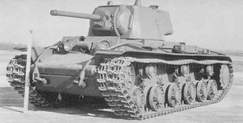

If you look at this pic you can see it's a straight line from idler to the return rollers with the last roller being slightly higher than the drive sprocket.

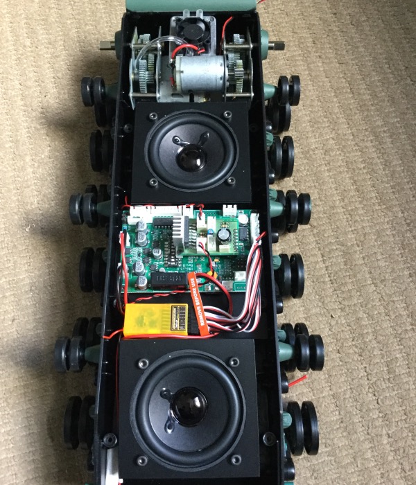

Got a little bit done last night,final fitting of the speaker boxes and a quick lick of paint to tidy things up.

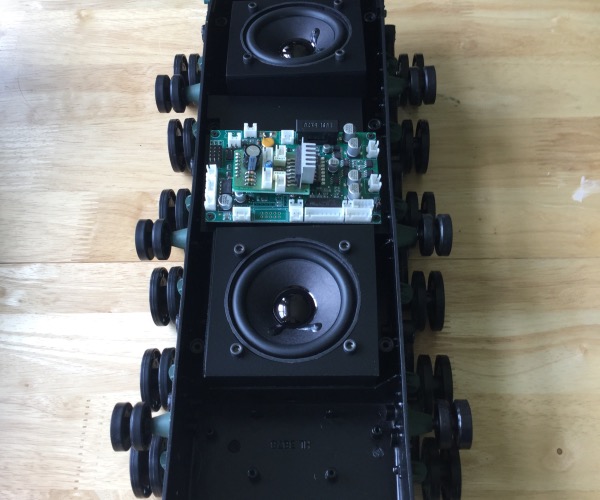

Fitted the gearboxes,smoker and receiver this morning then got the lower hull wired up.
Just looking at where I'm going to fit the volume controls at the moment.
