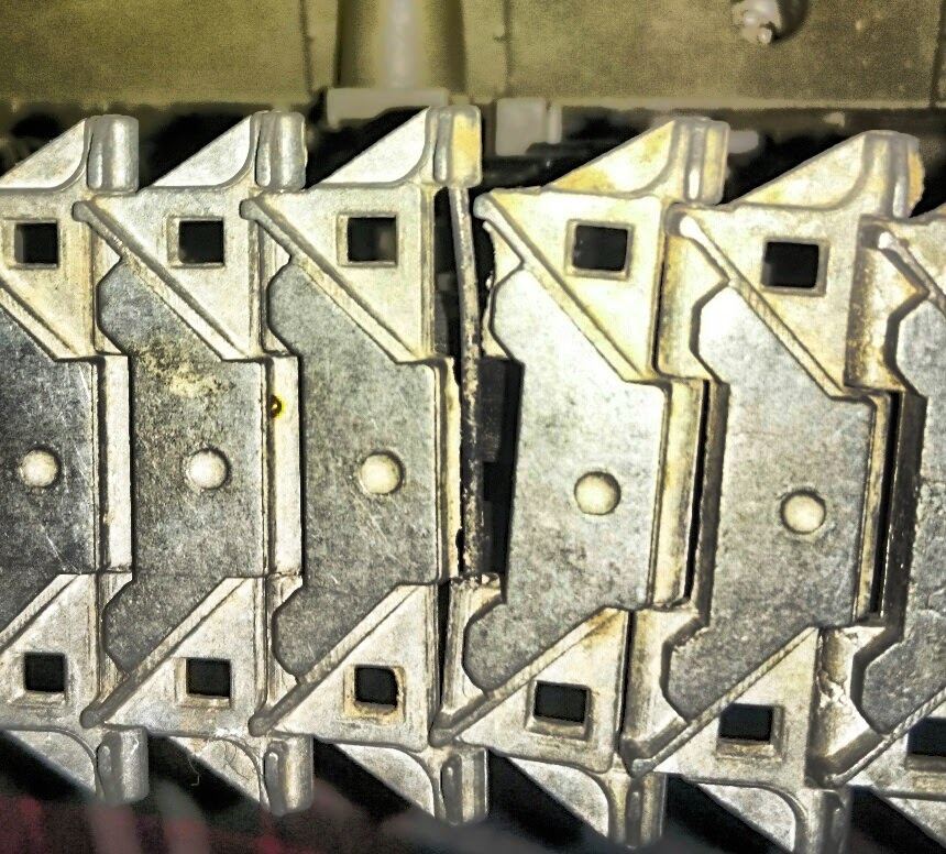

1: One segment of the metal track has partly snapped off.

2 and 3 should be a easy fix. The metal track I was thinking or more hoping some metal putty dremeled into shape would be a temporary fix for this. Have ordered a new crystal set.

Do yourself a favor and order a new set of plastic tracks or new links for the metal ones. New tracks can be plastic to begin with since those are quite durable and give good traction. Most importantly, if you order new tracks, add a link to either side when they arrive, before you mount them on the tank. Breakages like your photo depicts are most often the result of overly tight tracks right from the factory. Open the tank up as well when you can and check the gear boxes to make sure that nothing is out of alignment there due to the tight track issue on this one.
Regards and good luck bringing your Walker back to full operating capability!

Cheers PainlessWolf. Will have a look at getting some extra metal ones if not will order some plastic ones. Thanks for the heads up. Will check the gears later on.

All pretty easy fixes....go with the advice Painless gave you...loosen pins that hold the guide wheels...and solder that resistor...you should be running in no time
