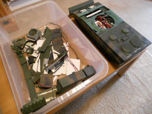

Now I know that I spent an awful long time building the Kodiak AEV, but try as I might I could never get the arm working fast enough to make it a worthwhile model. Believe me I tried everything, and was almost there, but at the end of the day...it was never going to be up to scratch. Seeing as bare hulls are like hens teeth nowadays, I bit the bullet and pulled it apart, so that I was back to what is basically a Leopard hull with big holes in it. The dozer blade worked a treat though.

So, after attacking the Kodiak and cutting my hands to pieces on sharp stryrene, this is my starting point.
The dozer blade will also come off as the Bergpanzer has a different shape and arms.

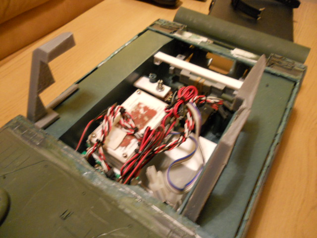

I am currently printing a skeleton for the crew quarters, doing it six sections in case anything goes pear shaped whilst printing, as that way I will only waste a small amount of filament and time, rather than the 35 hours that printing it in two sections would take. It will all be faced up with styrene, and mounted on a full width flat plate. I might have all of the sections done by this evening.
I should have cut the front deck out of the upper hull before I did all of this, I now discover that HL have track covers on the lower hull that don't quite line up with the track covers on the upper hull, the base of the new parts should sit almost level with the hinge line on the track guards. I will have to bodge my way around this as I need a lip to glue the new upper deck parts onto. This will in turn affect the roof height...grrrr...much cutting and grinding to do now.

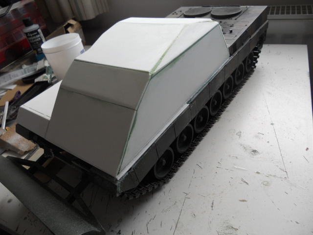

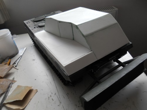

This was all a bit of a challenge, but I got there in the end. Bits of filling to do, but the main work is done on this part of the project.

Post by AlwynTurner »
Hi Rob coming along great. Looks like you had some interesting angles in there to contend with! Following along. :clap: :thumbup: :wave: Alwyn
