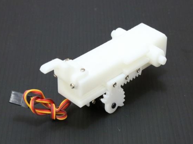

Clark site is really really confusing. He does not have an elevation kit yet, although the universal recoil kit is based on the Heng Long fitting so you can always keep the Heng Long elevation pinion, take out the Heng Long elevation unit and springs and put in your own servo for elevation, or use Clark's to control it (The Clark board servo elevation control is quite limited in range. I always just ended up hooking up the elevation servo directly to the radio and set it up thru the mixer).
Here is a quick video what you can do with servo elevation and rotation for moderns:
This is the servo recoil with Clark and a Heng Long Leo which would be very similar to the M1.

Watching some modern tanks doing gunnery from static positions, the whole tank shakes when the gun is fired. Not as violent as the standard HL recoil though, more like the suspension is soaking up the recoil so the tank's rear dips a bit. Alas, this movement seems to be difficult to simulate, the "best" so far is having the tank reverse a tiny distance by adjusting the recoil values in some boards (e.g., IBU). It isn't perfect though. I'm still trying to figure out how to make the rear dip instead of the whole tank reversing when the gun fires. That would be far more realistic than current fixes.
Firing on the move is possible with the IBU2. I've been running my M1 and firing the main gun and there's no problem. It doesn't even reverse when the tank is in motion.
As for realistic turret rotation, your best bet is using a 360-degree servo. Try looking up for the turret traverse speeds of real tanks and using the appropriate servo for it. In my M1's case, the turret traverse speed of the real thing is around 9 seconds. The servo I used gives me close to that. With some boards, turret traverse servo speed can be adjusted in the config file of the board (like the IBU2 Pro).
