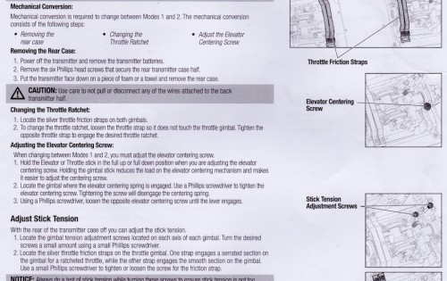

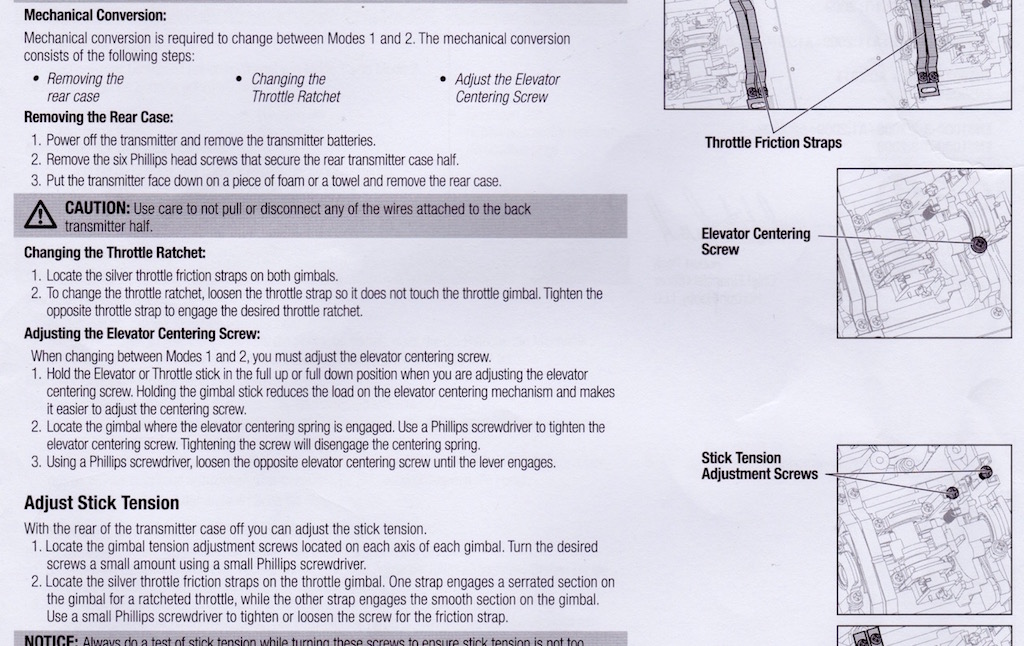

Hi, Tao
This illustration comes from an Addendum I received with my Spektrum manual, and it allowed me to self-centre my unit.It should work for you too, I hope:
Spectrum manual-addendum
