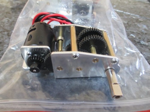

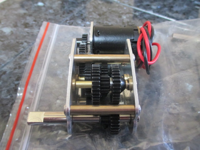

I just bought a Stug III and I put asiatam brass dual ratio (5:1) GBs in it and it runs great. Here it is just goofin' around on the carpet but if you want I'll get some outdoor video so you can see how those dual ratio GBs perform. One cool thing is that in a Stug or PzIII you can fit 380 motors to the dual ratio GBs. I have that set up in my PzIII and it's really good.

Thank you very much! I'm always happy to see how something performs. I don't have any brass gearboxes installed but I do have 380 and 400 motors in a couple of the heavier tanks. I believe the low profile gearboxes in my StuG use the 380s.
with all regards,
