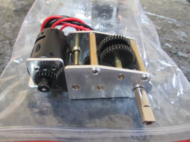

Posts: 7671
Re: Lowest/slowest ratio gearbox for Torro KT?
Max,
Thank you very much! I'm always happy to see how something performs. I don't have any brass gearboxes installed but I do have 380 and 400 motors in a couple of the heavier tanks. I believe the low profile gearboxes in my StuG use the 380s.
with all regards,
