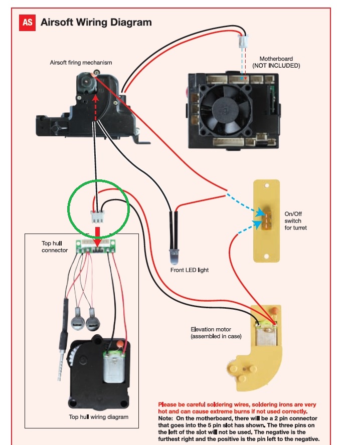

Ditch the HL airsoft shooting unit. Replace with the Taigen unit, it was redesigned in 2014. It is 99.993% compatible. Shoots better, more power, more accurate and most important more reliable shooting.
Here is the unit http://www.imex-model.com/product/TAG12 ... tml?cid=90
To swap:
The No Soldering method:
-Reuse the motor from the unit in your tank's unit now. https://youtu.be/DDYm7JS6Suw
Total unit replacement, requires soldering of 3 wires:
-Take pictures/notes before disassembly, noting point to point wiring, HL vs Taigen color code is a little different but circuit/electrical path is identical.
-Install new unit referencing your notes/pictures. Or come back here and post if issues arise (pics worth...)
Total unit replacement, none soldering:
-As above but cut and strip wires, wire nut or twist & tape or butt crimps.
I'd advise you get a 22 cal cleaning rod with lint free swabs and pure silicone spray. Clean the barrel while the battery is charging.
Examples:
