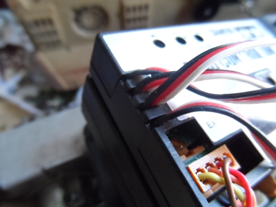

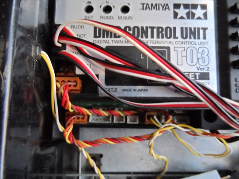

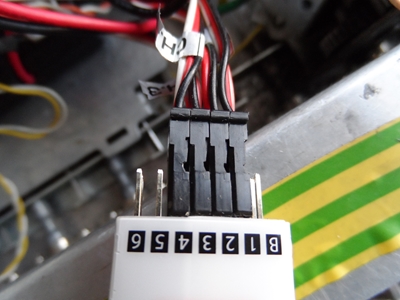

Sounds very strange. Was tested before I sent it, can you get any pictures of the wires that plug into the reciever? On one of my tanks I had to resolver these and I can't remember if it was this one. Might be a wire has come loose.
Jake79
Posts: 1062
Re: DMD-Planet T5
Post by Jake79 »

You've got the plugs to the reciver the wrong way around the white signal wire should be at the top :)
