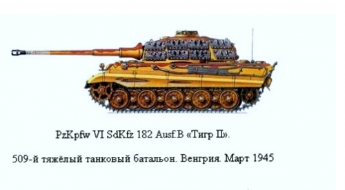

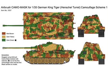

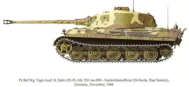

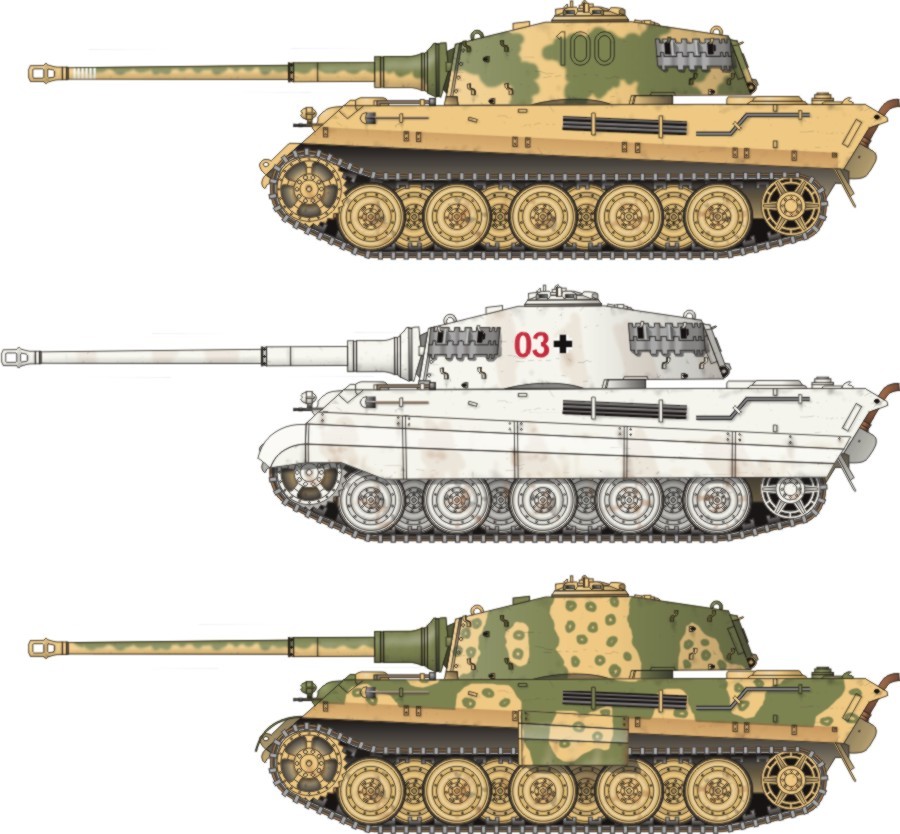

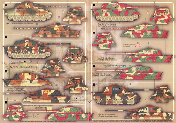

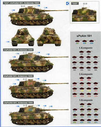

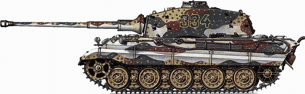

As for the King tiger-that's next on the list of course, but after painting this tank more times then I can count, I am in no hurry to botch it once more. I'm planning to add metal gearboxes before I paint. The zimmerit was the missing touch and should have added that first but choice of the camo scheme is just as important...here's some of camo schemes I am considering, your feedback is welcome! (If by some chance I nicked anyone's tank images, and you don't like it, please pm me or otherwise let me know and i will take the images down.) Also I have a small collection of camo but by no means comprehensive, anyone having any noteworthy, to you, camo schemes if you have time to put it up, I'd like to see more..the more the better.
#1
#2
#3
#4

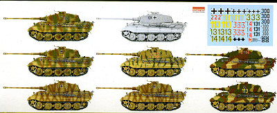

Here's a few I found..
Tamiya: 2 King Tigers
Jake79
Posts: 1058
Re: HL King Tiger Zimmerit/Tiger 1 Fixingfor Metal Tracks Ch
Post by Jake79 »
Few more..

Thanks everyone very much for help with the KT camo, please keep em coming! Most of these I had never seen before at all. Thinking back so far when I started in the hobby in the 1970's, probably what caused me to gravitate to the German tank models in the first place, 40 years ago....all those amazing camo schemes.
