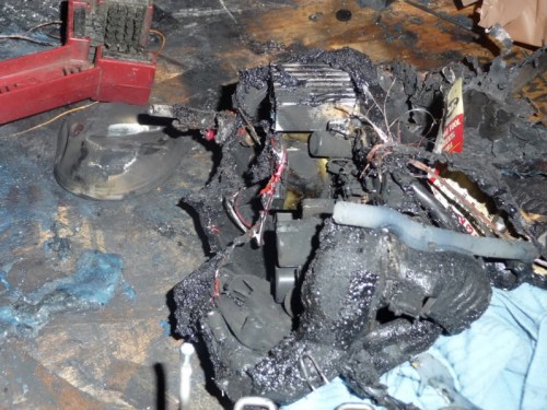

BOTTOM LINE................... LIPOS ARE BEST
HAPPY TANKING GENTS
HAPPY TANKING GENTS
- dgsselkirk
- Posts: 1510
Re: Which Is Better
Lipo? I think not!
