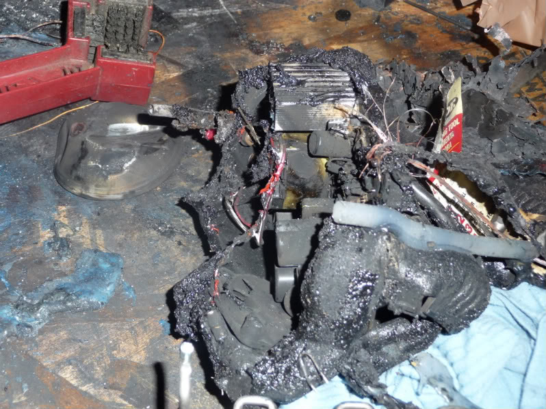

BOTTOM LINE................... LIPOS ARE BEST :haha: :haha: :haha: :haha:
HAPPY TANKING GENTS Image
dgsselkirk
Posts: 1510
Re: Which Is Better
Post by dgsselkirk »
Lipo? I think not!
