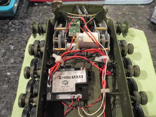

Re: Rx 18 + Rear lights
Hi, new here & doing the same thing. This is NOT confirmed as of yet but I believe the red/black wires from the rear lights can be connected to the green & white wires of the hull 8-pin connector.red is +ve & should probably go to the green & black to the white to maintain polarity.

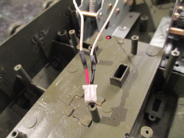

Sorry to appear dense (probably because I am), but this plug with this polarity?
Just confirming 100%, thanks.
Red =+ve/ Blk =-ve
Red =+ve/ Blk =-ve
- Posts: 7860
Spam,
Good afternoon. That's correct. Worked great on my Pershing build.
Thanks! Off to dig out the soldering iron!
Done!
Works great, but startup is "different". No flashing just waits to complete power up & start sequence then comes on. No biggie but if you do the mod don't panic if there's a 3~4 sec delay on startup & only the headlights flash now.
