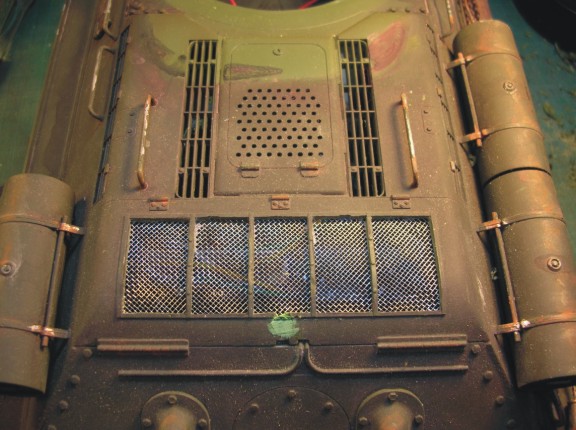

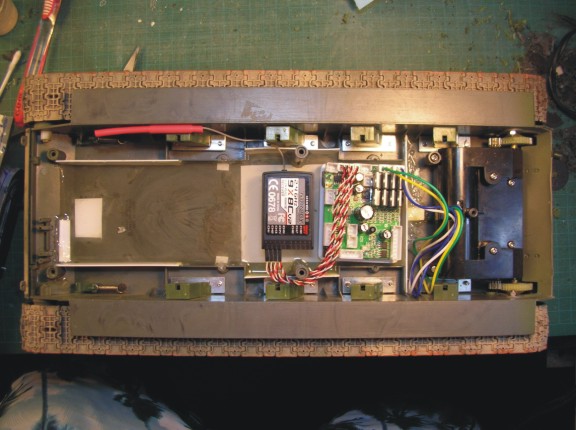

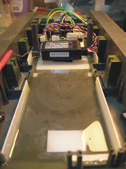

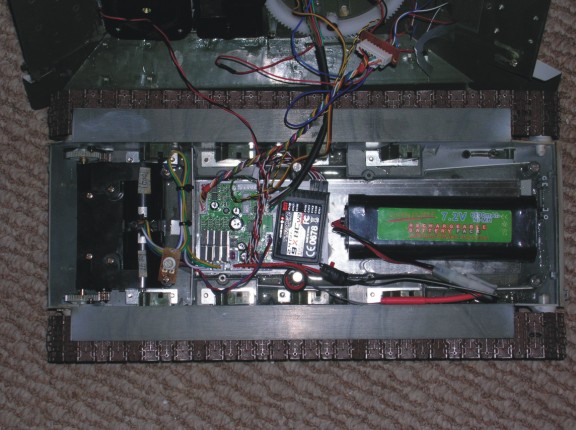

I will be interested to hear about the metal for sure. I will be gutting the lower hull and installing a heavy (relatively) metal plate in the base like I did on the WSN's that seemed to help. They run pretty good on our club battlefield (See first 2 pictures below of my winter T-34/85 layout) The way I did it was gut the hull, put in styrene to protect the suspensions, pour in thin layer of resin, add metal plate when this was dry and then another layer of resin. This is the insulation for electronics from the metal plate. I didn't look to see if I had metal gearboxes as I have a set of Panthers that should fit. Will have to look. B|
Also here is my spring T-34/85 to show you before metal plate was laid in but with Clark test fitted. Also just for fun a shot of my grill replacement. :D
