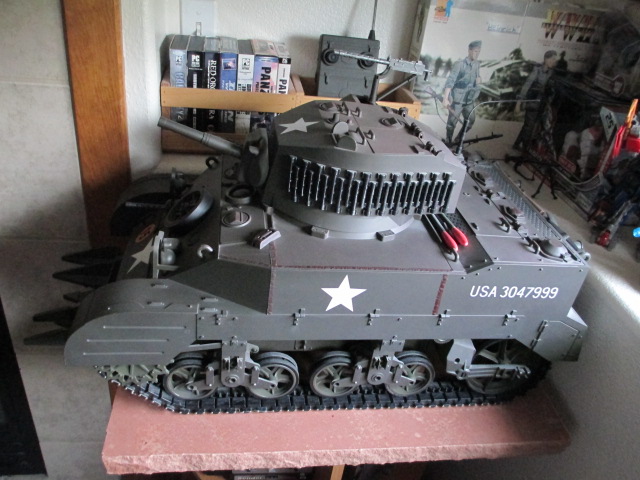

Measurements of my stock M5 are as follows: (in standard inches)
H: 16" w\o Browning 30 cal ( 18" with )
W: 15"
L: 29" with fender skirts (no w\hedgerow cutter measurements taken as they did not land on the beach with them...if required, I can provide )
Painless Wolf

Thanks PainlessWolf, that's just what I was looking for... and in proper "old money" too :)
