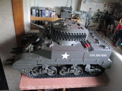

Good Evening,
Measurements of my stock M5 are as follows: (in standard inches)
H: 16" w\o Browning 30 cal ( 18" with )
W: 15"
L: 29" with fender skirts (no w\hedgerow cutter measurements taken as they did not land on the beach with them...if required, I can provide )
Painless Wolf
