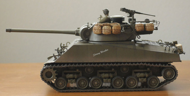

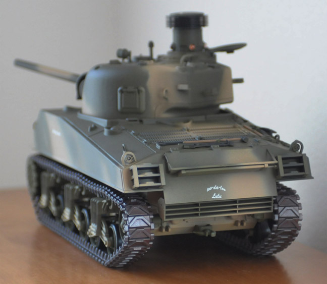

HL + Tamiya conversion, and I guess this is now a "Hemiya" Sherman and painted as a Mediterranean Theater of Operations Sherman M4A3W 75mm.
Enjoy, John
Uses Nick's resin Sherman 75mm mantlet and scale barrel kit: ndaguilar@grandecom.net
With Tamiya Battle Unit.

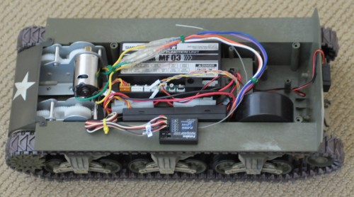

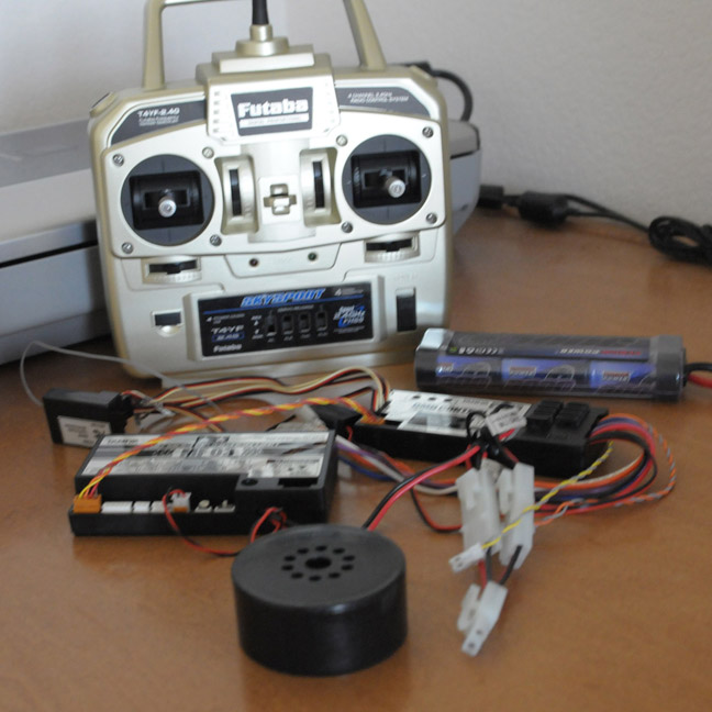

Converted to Tamiya Pershing Electronics and Tamiya 380 motors.

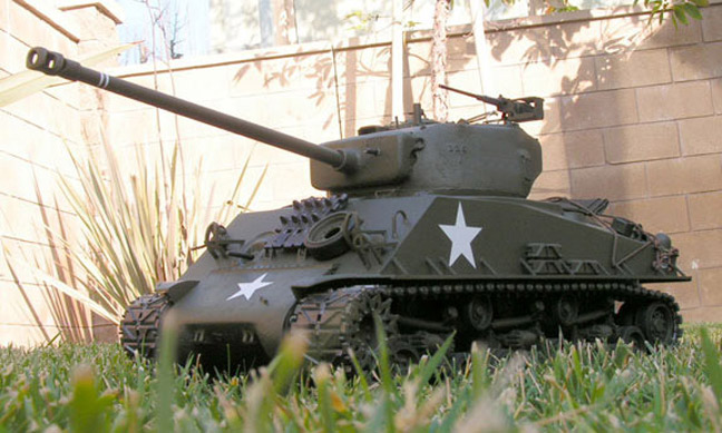

Good runner. Basic HL Sherman with plastic tracks which work good on grass.

Nice and clean! :thumbup:

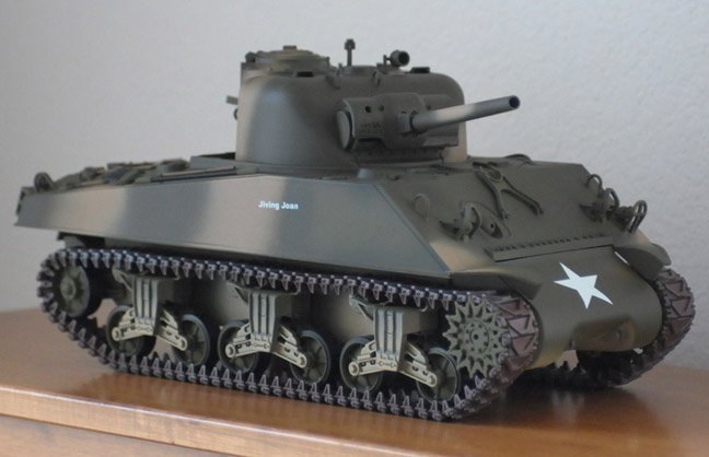

Great work as always John!
If you don't mind me asking, where do you get the custom marking decals?
Tamiya Tiger 1, Tamiya M4 (105) HVSS, Tamiya Jagdpanther G1, ElMod Jagdpanther G2, ElMod KV-1E, ElMod StuG 40 G
Pcomm1
Posts: 287
Joined: Tue Jun 23, 2009 7:27 pm
Re: HL Sherman M4A3W 75mm Conversion
Post by Pcomm1 »
Visit http://www.getstencils.com/Dry_Transfers.html
I used their Dry Transfers rub down type sealed on both Shermans with several very light layers of Testors Dullcote.
If you have graphics software just make your "type art" in inDesign and email them a pdf.
No graphics software, then on an email page or in MS Word set the "sized" type (to fit the model) and step and repeat the words a dozen times on the page to have spares.
This becomes the Dry Transfer "art work". I emailed the "art" to "get stencils" with my color call out = white.
Call out your color using a PMS Color Chart: http://andprinting.com/imgs/pantone_chart.pdf
FYI: Like all the improvements you've made to Jiving Joan II, looks great!
Enjoy, John

The emitter is on the barrel now because the LED is to big to fit inside the scale 75mm barrel, so much for careful planning.
Enjoy, John
Runs strong and handles shoot and scoot missions against the Tiger II nicely.
Tamiya Pershing DMD MFU setup.
