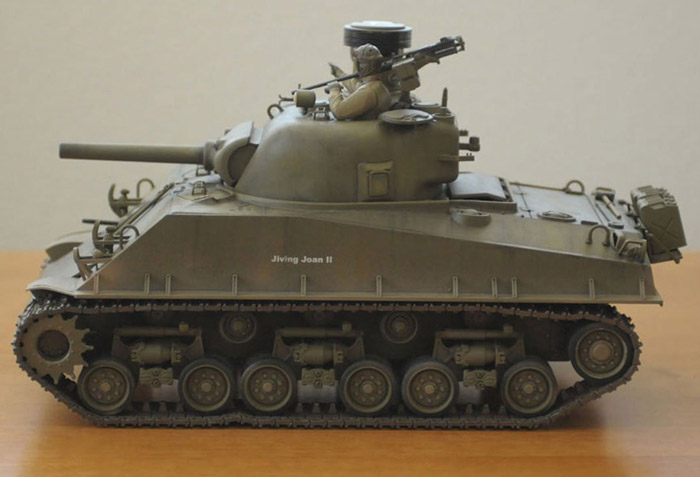

Re: Tamiya Sherman build questions
Reference:
The Tamiya kit
Daryl's idler upgrade
Daryl's screws
Ball bearings
Impact transmission w/ DDG installed
Kenny's T66 tracks
Nicks E8 76mm conversion
Recommended additions for your Tamiya Sherman Kit List:
1. Daryl's gearbox mount brace, DPE06: http://www.etoarmour.com/products.php?ViewCategory=11
2. Two cent tip:
Skip the Impact gear boxes, no need for a Sherman.
Instead get from ETO the M02, two powerful black long can motors for the Tamiya transmissions.
Much more torque and power for your tank, keeps power up better in combat. Fits all Tamiya tanks except Leopard 2A6.
Bolts directly on to transmission in place of the stock motors.
Dimensions: 27,7mm wide x 51,0mm long.
Shaft size: 2.3mm.
Sold as a pair only (look towards the bottom of the page): http://www.etoarmour.com/products.php?ViewCategory=10
3. For your new motors get the Impact 8 Tooth Pinion gears (2): http://mitosal.com/M4Sherman.html
4. Remove and CA Glue the clutch gears solid for the rotation unit and the elevation unit and re-install in reverse order after the glue dries hard.
5. Check out ETO for your T66 tracks, they ship from NJ and they are an excellent vendor: http://www.etoarmour.com/product_detail ... tID=KKT005
Have fun and these are the same parts that I used for the Tamiya Sherman below, a very strong runner.
Enjoy, John
