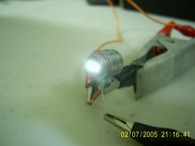

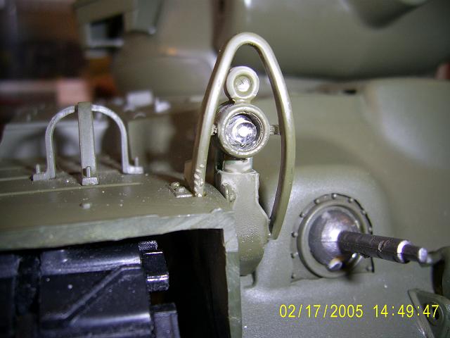

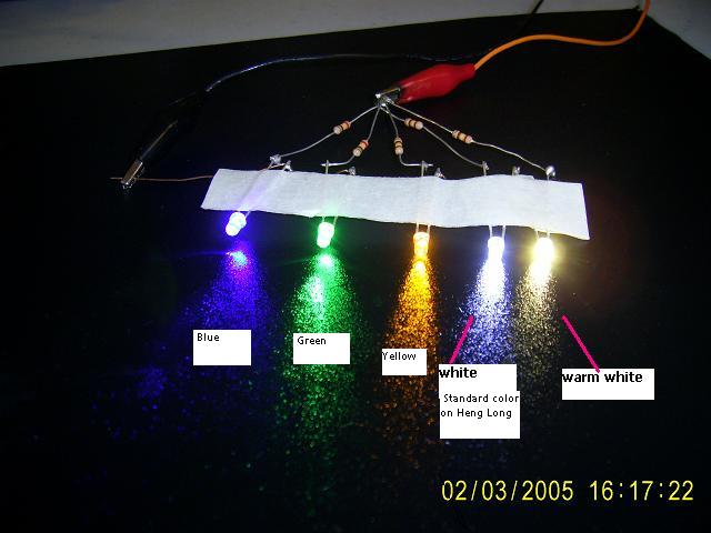

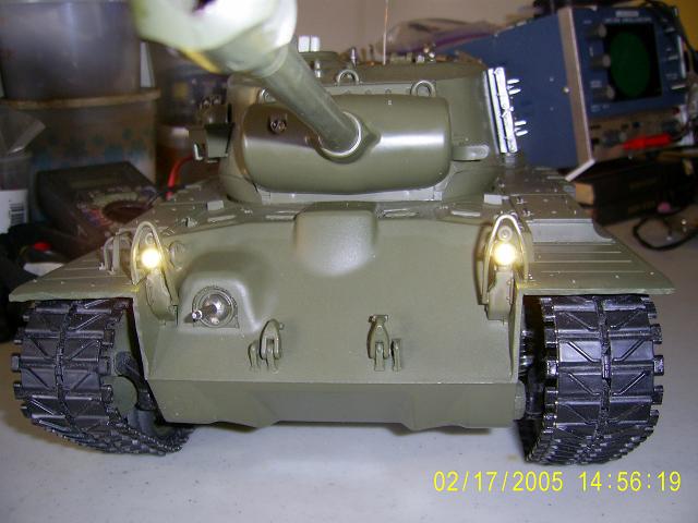

I replaced the original 5 mm leds on my H.L. Panzer IV and Pershing ; by 3mm flat top "warm white" without changing the resistors..
The "warm white" gives you a color closer to the real thing than the "white" ...
Here's some pics :

I have to say that the 'warm white' does look great! I'm going to order some! :thumbup:
