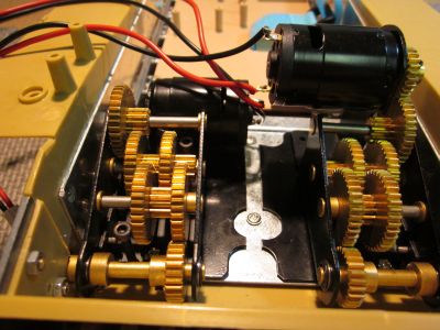

Gearbox 1 Check Shaft Protrusion.jpg (39.08 KiB) Viewed 1099 times
The shaft protrusion is important, you have to match it with the new set up.

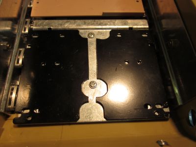

Gearbox 2 Cut Plate.jpg (33.47 KiB) Viewed 1099 times
Cut the plate down the middle so you can spread it enough to get the shaft protrusion needed with the Waltersons

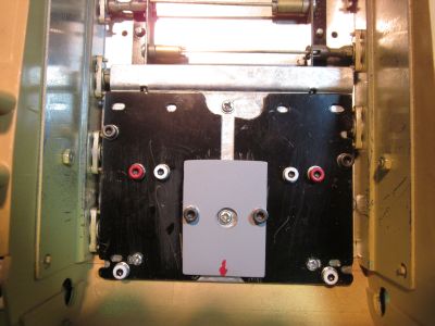

Gearbox 3 Cut New Plate Mounting Holes.jpg (36.68 KiB) Viewed 1099 times
Cut some new holes to match the threaded holes in the plate in the Taigen Tiger I

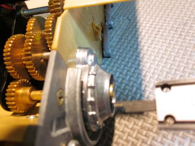

Gearbox 4 Match Shaft Protrusion.jpg (44.66 KiB) Viewed 1099 times
Get the protrusion you need with the Waltersons.

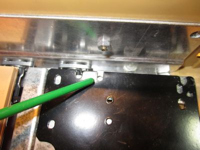

Gearbox 5 Mounting Plate Installed.jpg (37.37 KiB) Viewed 1099 times
The grey plate is a piece of steel used to hold things down.
I used 3mm hex head cap screws.
The cap screws for the gearbox mounts are colour coded, the red one is cut short so it doesn't impact on the frame rail under the plate in the Taigen.
